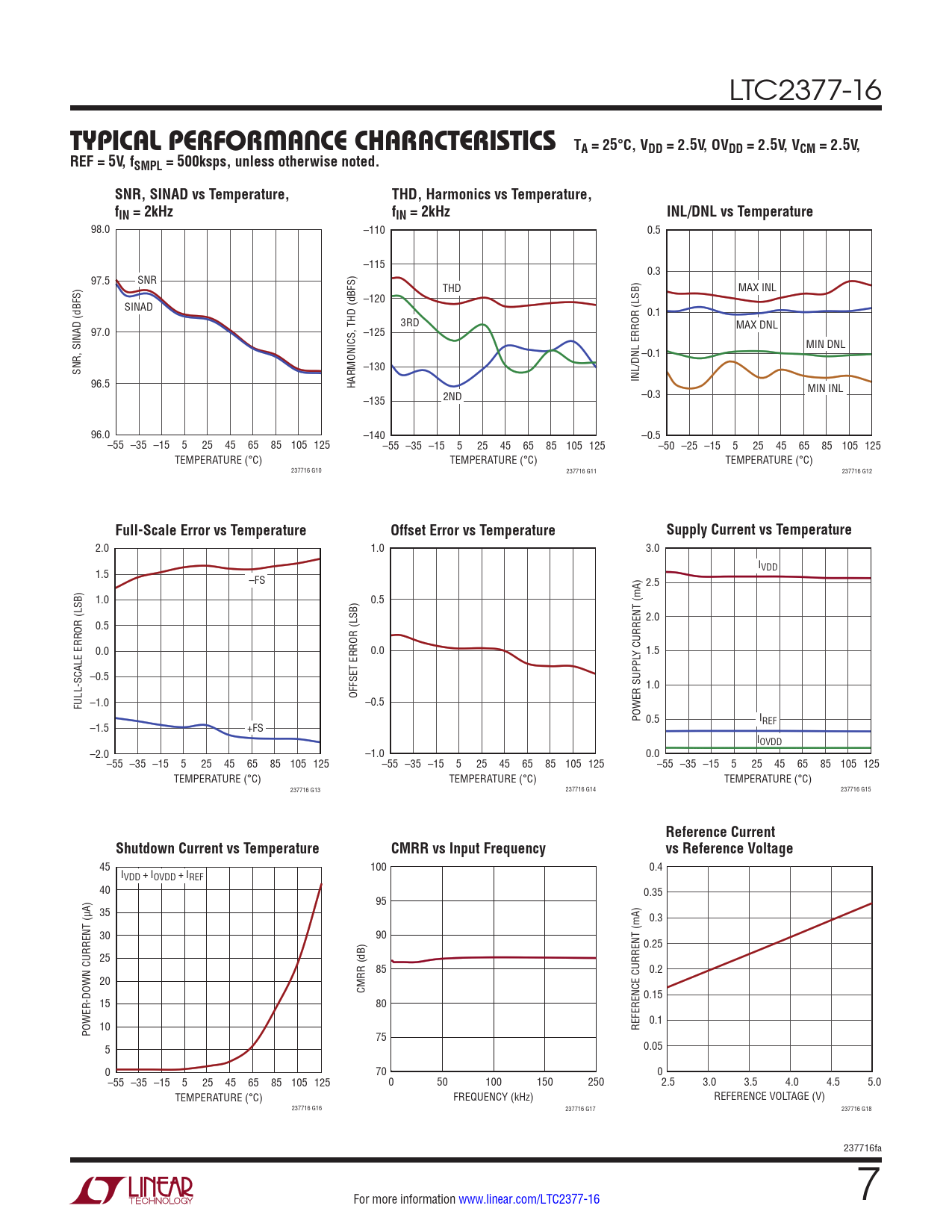

TYPICAL PERFORMANCE CHARACTERISTICS. TA = 25°C, VDD = 2.5V, OVDD = 2.5V, VCM = 2.5V,
LTC2377-16
TYPICAL PERFORMANCE CHARACTERISTICS TA = 25°C, VDD = 2.5V, OVDD = 2.5V, VCM = 2.5V, REF = 5V, fSMPL = 500ksps, unless otherwise noted. SNR, SINAD vs Temperature, THD, Harmonics vs Temperature, fIN = 2kHz fIN = 2kHz INL/DNL vs Temperature
98.0 –110 0.5 –115 0.3 97.5 SNR THD MAX INL –120 SINAD 0.1 3RD MAX DNL 97.0 –125 MIN DNL –0.1 SNR, SINAD (dBFS) –130 96.5 INL/DNL ERROR (LSB) HARMONICS, THD (dBFS) –0.3 MIN INL –135 2ND 96.0 –140 –0.5 –55 –35 –15 5 25 45 65 85 105 125 –55 –35 –15 5 25 45 65 85 105 125 –50 –25 –15 5 25 45 65 85 105 125 TEMPERATURE (°C) TEMPERATURE (°C) TEMPERATURE (°C) 237716 G10 237716 G11 237716 G12
Full-Scale Error vs Temperature Offset Error vs Temperature Supply Current vs Temperature
2.0 1.0 3.0 I 1.5 VDD –FS 2.5 1.0 0.5 2.0 0.5 0.0 0.0 Y CURRENT (mA) 1.5 –0.5 1.0 OFFSET ERROR (LSB) FULL-SCALE ERROR (LSB) –1.0 –0.5 POWER SUPPL 0.5 IREF –1.5 +FS IOVDD –2.0 –1.0 0.0 –55 –35 –15 5 25 45 65 85 105 125 –55 –35 –15 5 25 45 65 85 105 125 –55 –35 –15 5 25 45 65 85 105 125 TEMPERATURE (°C) TEMPERATURE (°C) TEMPERATURE (°C) 237716 G13 237716 G14 237716 G15
Reference Current Shutdown Current vs Temperature CMRR vs Input Frequency vs Reference Voltage
45 100 0.4 IVDD + IOVDD + IREF 40 0.35 95 35 0.3 30 90 0.25 25 85 0.2 20 CMRR (dB) 0.15 15 80 10 REFERENCE CURRENT (mA) 0.1 POWER-DOWN CURRENT (µA) 75 0.05 5 0 70 0 –55 –35 –15 5 25 45 65 85 105 125 0 50 100 150 250 2.5 3.0 3.5 4.0 4.5 5.0 TEMPERATURE (°C) FREQUENCY (kHz) REFERENCE VOLTAGE (V) 237716 G16 237716 G17 237716 G18 237716fa For more information www.linear.com/LTC2377-16 7 Document Outline Features Applications Description Typical Application Absolute Maximum Ratings Pin Configuration Order Information Electrical Characteristics Converter Characteristics Dynamic Accuracy Reference Input Digital Inputs and Digital Outputs Power Requirements ADC Timing Characteristics Typical Performance Characteristics Pin Functions Functional Block Diagram Timing Diagram Applications Information Board Layout Package Description Revision History Typical Application Related Parts
