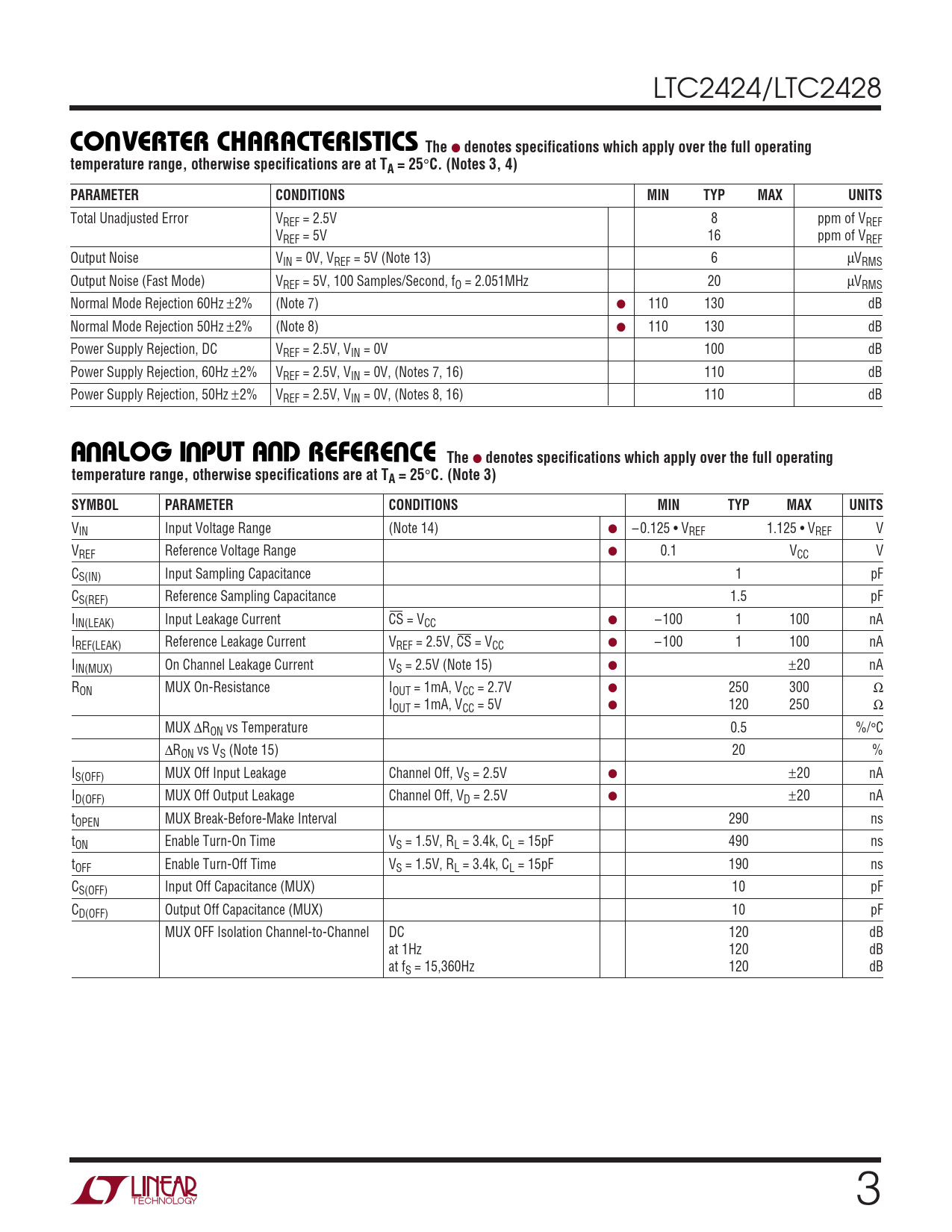

CONVERTER CHARACTERISTICS The. denotes specifications which apply over the full operating
CONVERTER CHARACTERISTICS The denotes specifications which apply over the full operating
LTC2424/LTC2428
U CONVERTER CHARACTERISTICS The
denotes specifications which apply over the full operating temperature range, otherwise specifications are at TA = 25
C. (Notes 3, 4) PARAMETER CONDITIONS MIN TYP MAX UNITS
Total Unadjusted Error VREF = 2.5V 8 ppm of VREF VREF = 5V 16 ppm of VREF Output Noise VIN = 0V, VREF = 5V (Note 13) 6 µVRMS Output Noise (Fast Mode) VREF = 5V, 100 Samples/Second, fO = 2.051MHz 20 µVRMS Normal Mode Rejection 60Hz ±2% (Note 7) ● 110 130 dB Normal Mode Rejection 50Hz ±2% (Note 8) ● 110 130 dB Power Supply Rejection, DC VREF = 2.5V, VIN = 0V 100 dB Power Supply Rejection, 60Hz ±2% VREF = 2.5V, VIN = 0V, (Notes 7, 16) 110 dB Power Supply Rejection, 50Hz ±2% VREF = 2.5V, VIN = 0V, (Notes 8, 16) 110 dB
U U U U A ALOG I PUT A D REFERE CE The
C. (Note 3) SYMBOL PARAMETER CONDITIONS MIN TYP MAX UNITS
VIN Input Voltage Range (Note 14) ● – 0.125 • VREF 1.125 • VREF V VREF Reference Voltage Range ● 0.1 VCC V CS(IN) Input Sampling Capacitance 1 pF CS(REF) Reference Sampling Capacitance 1.5 pF IIN(LEAK) Input Leakage Current CS = VCC ● –100 1 100 nA IREF(LEAK) Reference Leakage Current VREF = 2.5V, CS = VCC ● – 100 1 100 nA IIN(MUX) On Channel Leakage Current VS = 2.5V (Note 15) ● ±20 nA RON MUX On-Resistance IOUT = 1mA, VCC = 2.7V ● 250 300 Ω IOUT = 1mA, VCC = 5V ● 120 250 Ω MUX ∆RON vs Temperature 0.5 %/°C ∆RON vs VS (Note 15) 20 % IS(OFF) MUX Off Input Leakage Channel Off, VS = 2.5V ● ±20 nA ID(OFF) MUX Off Output Leakage Channel Off, VD = 2.5V ● ±20 nA tOPEN MUX Break-Before-Make Interval 290 ns tON Enable Turn-On Time VS = 1.5V, RL = 3.4k, CL = 15pF 490 ns tOFF Enable Turn-Off Time VS = 1.5V, RL = 3.4k, CL = 15pF 190 ns CS(OFF) Input Off Capacitance (MUX) 10 pF CD(OFF) Output Off Capacitance (MUX) 10 pF MUX OFF Isolation Channel-to-Channel DC 120 dB at 1Hz 120 dB at fS = 15,360Hz 120 dB 3
