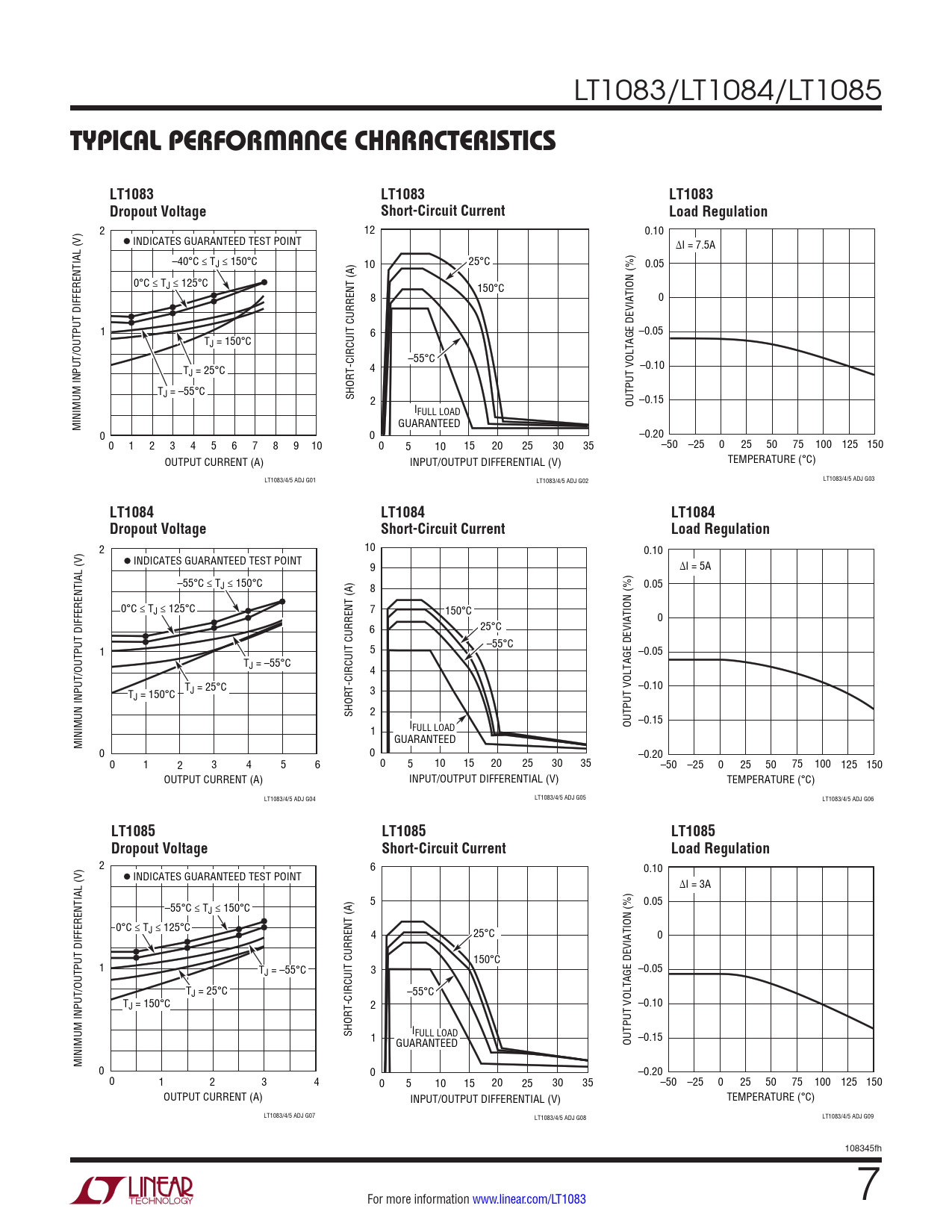

Typical perForMance characTerisTics. LT1083. Dropout Voltage. Short-Circuit Current. Load Regulation. LT1084. LT1085
LT1083/LT1084/LT1085
Typical perForMance characTerisTics LT1083 LT1083 LT1083 Dropout Voltage Short-Circuit Current Load Regulation
2 12 0.10 INDICATES GUARANTEED TEST POINT ∆I = 7.5A –40°C ≤ TJ ≤ 150°C 10 25°C 0.05 0°C ≤ TJ ≤ 125°C 150°C 8 0 1 6 –0.05 TJ = 150°C –55°C T –0.10 J = 25°C 4 TJ = –55°C SHORT-CIRCUIT CURRENT (A) 2 I OUTPUT VOLTAGE DEVIATION (%) –0.15 FULL LOAD MINIMUM INPUT/OUTPUT DIFFERENTIAL (V) GUARANTEED 0 0 –0.20 0 1 2 3 4 5 6 7 8 9 10 0 5 10 15 20 25 30 35 –50 –25 0 25 50 75 100 125 150 OUTPUT CURRENT (A) INPUT/OUTPUT DIFFERENTIAL (V) TEMPERATURE (°C) LT1083/4/5 ADJ G01 LT1083/4/5 ADJ G02 LT1083/4/5 ADJ G03
LT1084 LT1084 LT1084 Dropout Voltage Short-Circuit Current Load Regulation
2 10 0.10 INDICATES GUARANTEED TEST POINT 9 ∆I = 5A –55°C ≤ TJ ≤ 150°C 8 0.05 0°C ≤ TJ ≤ 125°C 7 150°C 0 6 25°C –55°C 1 5 –0.05 TJ = –55°C 4 T –0.10 T J = 25°C 3 J = 150°C SHORT-CIRCUIT CURRENT (A) 2 –0.15 OUTPUT VOLTAGE DEVIATION (%) 1 IFULL LOAD MINIMUN INPUT/OUTPUT DIFFERENTIAL (V) GUARANTEED 0 0 –0.20 0 1 2 3 4 5 6 0 5 10 15 20 25 30 35 –50 –25 0 25 50 75 100 125 150 OUTPUT CURRENT (A) INPUT/OUTPUT DIFFERENTIAL (V) TEMPERATURE (°C) LT1083/4/5 ADJ G04 LT1083/4/5 ADJ G05 LT1083/4/5 ADJ G06
LT1085 LT1085 LT1085 Dropout Voltage Short-Circuit Current Load Regulation
2 6 0.10 INDICATES GUARANTEED TEST POINT ∆I = 3A 5 0.05 –55°C ≤ TJ ≤ 150°C 0°C ≤ TJ ≤ 125°C 4 25°C 0 150°C 1 TJ = –55°C 3 –0.05 TJ = 25°C –55°C TJ = 150°C 2 –0.10 SHORT-CIRCUIT CURRENT (A) I 1 FULL LOAD –0.15 GUARANTEED OUTPUT VOLTAGE DEVIATION (%) MINIMUM INPUT/OUTPUT DIFFERENTIAL (V) 0 0 –0.20 0 1 2 3 4 0 5 10 15 20 25 30 35 –50 –25 0 25 50 75 100 125 150 OUTPUT CURRENT (A) INPUT/OUTPUT DIFFERENTIAL (V) TEMPERATURE (°C) LT1083/4/5 ADJ G07 LT1083/4/5 ADJ G08 LT1083/4/5 ADJ G09 108345fh For more information www.linear.com/LT1083 7 Document Outline Features Applications Typical Application Description Absolute Maximum Ratings Pin Configuration Order Information Electrical Characteristics Typical Performance Characteristics Block Diagram Applications Information Typical Application Package Description Revision History Typical Applications Related Parts
