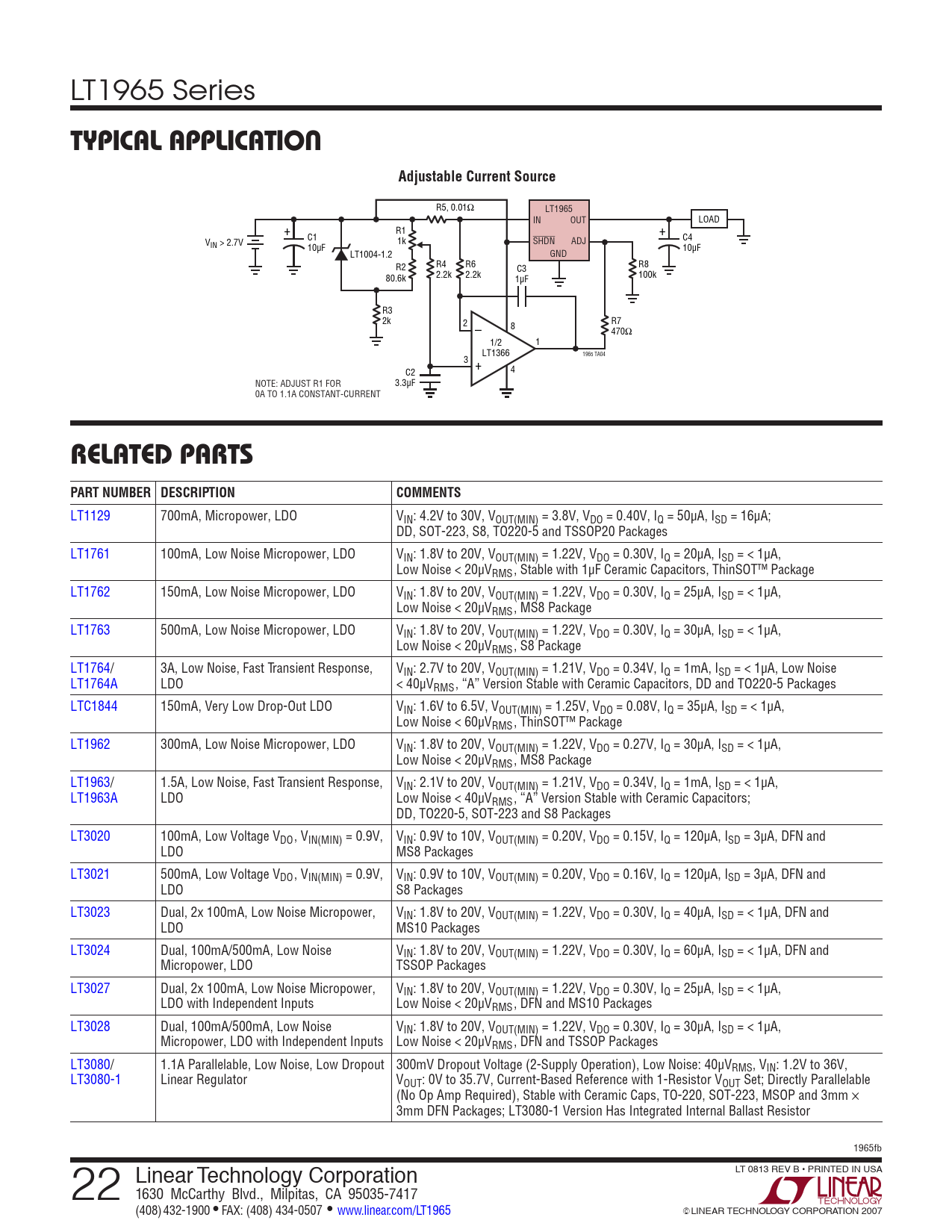

typical application Adjustable Current Source
R5, 0.01Ω LT1965 IN OUT LOAD + R1 + V C4 IN > 2.7V C1 1k SHDN ADJ 10µF 10µF LT1004-1.2 GND R2 R4 R6 R8 C3 80.6k 2.2k 2.2k 100k 1µF R3 2k R7 2 – 8 470Ω 1/2 1 LT1366 3 1965 TA04 + 4 C2 NOTE: ADJUST R1 FOR 3.3µF 0A TO 1.1A CONSTANT-CURRENT
