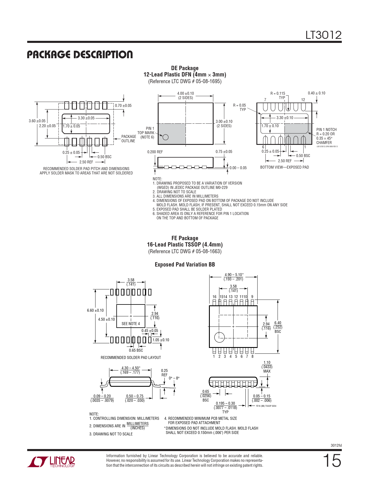

PACKAGE DESCRIPTION. DE Package. 12-Lead Plastic DFN (4mm. 3mm). FE Package. 16-Lead Plastic TSSOP (4.4mm)
PACKAGE DESCRIPTION DE Package 12-Lead Plastic DFN (4mm 3mm) FE Package 16-Lead Plastic TSSOP (4.4mm)
LT3012
3mm)
(Reference LTC DWG # 05-08-1695) 4.00 ±0.10 R = 0.115 0.40 ± 0.10 (2 SIDES) TYP 7 12 0.70 ±0.05 R = 0.05 TYP 3.30 ±0.05 3.30 ±0.10 3.60 ±0.05 3.00 ±0.10 2.20 ±0.05 1.70 ± 0.05 (2 SIDES) 1.70 ± 0.10 PIN 1 PIN 1 NOTCH TOP MARK R = 0.20 OR PACKAGE (NOTE 6) 0.35 × 45° OUTLINE CHAMFER 6 1 (UE12/DE12) DFN 0806 REV D 0.25 ± 0.05 0.200 REF 0.75 ±0.05 0.25 ± 0.05 0.50 BSC 0.50 BSC 2.50 REF 2.50 REF RECOMMENDED SOLDER PAD PITCH AND DIMENSIONS 0.00 – 0.05 BOTTOM VIEW—EXPOSED PAD APPLY SOLDER MASK TO AREAS THAT ARE NOT SOLDERED NOTE: 1. DRAWING PROPOSED TO BE A VARIATION OF VERSION (WGED) IN JEDEC PACKAGE OUTLINE M0-229 2. DRAWING NOT TO SCALE 3. ALL DIMENSIONS ARE IN MILLIMETERS 4. DIMENSIONS OF EXPOSED PAD ON BOTTOM OF PACKAGE DO NOT INCLUDE MOLD FLASH. MOLD FLASH, IF PRESENT, SHALL NOT EXCEED 0.15mm ON ANY SIDE 5. EXPOSED PAD SHALL BE SOLDER PLATED 6. SHADED AREA IS ONLY A REFERENCE FOR PIN 1 LOCATION ON THE TOP AND BOTTOM OF PACKAGE
(Reference LTC DWG # 05-08-1663)
Exposed Pad Variation BB
