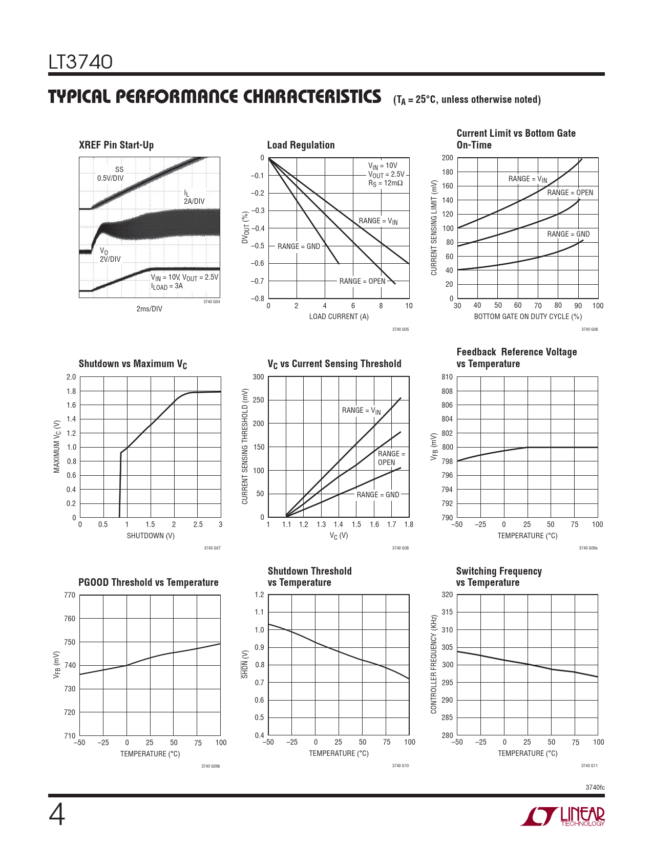

TYPICAL PERFORMANCE CHARACTERISTICS (TA = 25°C, unless otherwise noted). Current Limit vs Bottom Gate. XREF Pin Start-Up
TYPICAL PERFORMANCE CHARACTERISTICS (TA = 25°C, unless otherwise noted) Current Limit vs Bottom Gate XREF Pin Start-Up
LT3740
TYPICAL PERFORMANCE CHARACTERISTICS (TA = 25°C, unless otherwise noted) Current Limit vs Bottom Gate XREF Pin Start-Up Load Regulation On-Time
0 200 V SS IN = 10V V 180 0.5V/DIV –0.1 OUT = 2.5V RANGE = V R IN S = 12mΩ 160 IL –0.2 RANGE = OPEN 2A/DIV 140 –0.3 120 (%) RANGE = VIN –0.4 100 OUT RANGE = GND DV –0.5 80 RANGE = GND VO 2V/DIV 60 –0.6 CURRENT SENSING LIMIT (mV) 40 VIN = 10V, VOUT = 2.5V –0.7 RANGE = OPEN I 20 LOAD = 3A –0.8 0 3740 G04 2ms/DIV 0 2 4 6 8 10 30 40 50 60 70 80 90 100 LOAD CURRENT (A) BOTTOM GATE ON DUTY CYCLE (%) 3740 G05 3740 G06
Feedback Reference Voltage Shutdown vs Maximum VC VC vs Current Sensing Threshold vs Temperature
2.0 300 810 1.8 808 250 1.6 806 RANGE = VIN 1.4 804 200 (V) C 1.2 802 1.0 150 (mV) 800 RANGE = FBV 0.8 OPEN 798 MAXIMUM V 100 0.6 796 0.4 794 50 RANGE = GND 0.2 CURRENT SENSING THRESHOLD (mV) 792 0 0 790 0 0.5 1 1.5 2 2.5 3 1 1.1 1.2 1.3 1.4 1.5 1.6 1.7 1.8 –50 –25 0 25 50 75 100 SHUTDOWN (V) VC (V) TEMPERATURE (°C) 3740 G07 3740 G08 3740 G09a
Shutdown Threshold Switching Frequency PGOOD Threshold vs Temperature vs Temperature vs Temperature
