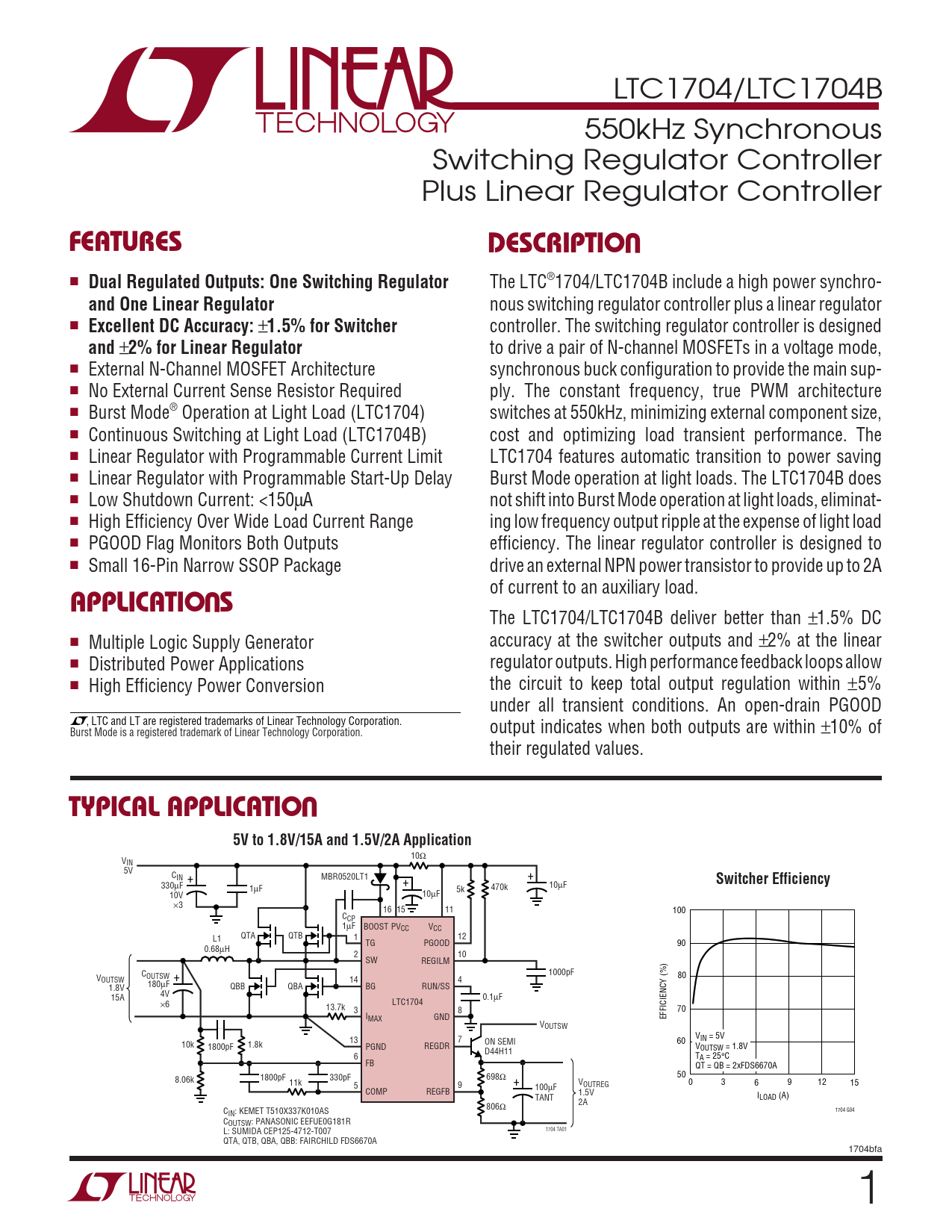

FEATURES. DESCRIPTIO. Dual Regulated Outputs: One Switching Regulator. and One Linear Regulator. Excellent DC Accuracy:

LTC1704/LTC1704B 550kHz Synchronous Switching Regulator Controller Plus Linear Regulator Controller
U FEATURES DESCRIPTIO
The LTC®1704/LTC1704B include a high power synchro-
nous switching regulator controller plus a linear regulator ■
1.5% for Switcher
controller. The switching regulator controller is designed
and
2% for Linear Regulator
to drive a pair of N-channel MOSFETs in a voltage mode, ■ External N-Channel MOSFET Architecture synchronous buck configuration to provide the main sup- ■ No External Current Sense Resistor Required ply. The constant frequency, true PWM architecture ■ Burst Mode® Operation at Light Load (LTC1704) switches at 550kHz, minimizing external component size, ■ Continuous Switching at Light Load (LTC1704B) cost and optimizing load transient performance. The ■ Linear Regulator with Programmable Current Limit LTC1704 features automatic transition to power saving ■ Linear Regulator with Programmable Start-Up Delay Burst Mode operation at light loads. The LTC1704B does ■ Low Shutdown Current: <150µA not shift into Burst Mode operation at light loads, eliminat- ■ High Efficiency Over Wide Load Current Range ing low frequency output ripple at the expense of light load ■ PGOOD Flag Monitors Both Outputs efficiency. The linear regulator controller is designed to ■ Small 16-Pin Narrow SSOP Package drive an external NPN power transistor to provide up to 2A

of current to an auxiliary load.

The LTC1704/LTC1704B deliver better than ±1.5% DC ■ Multiple Logic Supply Generator accuracy at the switcher outputs and ±2% at the linear ■ Distributed Power Applications regulator outputs. High performance feedback loops allow ■ High Efficiency Power Conversion the circuit to keep total output regulation within ±5% under all transient conditions. An open-drain PGOOD , LTC and LT are registered trademarks of Linear Technology Corporation. Burst Mode is a registered trademark of Linear Technology Corporation. output indicates when both outputs are within ±10% of their regulated values.
U TYPICAL APPLICATIO 5V to 1.8V/15A and 1.5V/2A Application
10Ω VIN 5V CIN MBR0520LT1 + +
Switcher Efficiency
