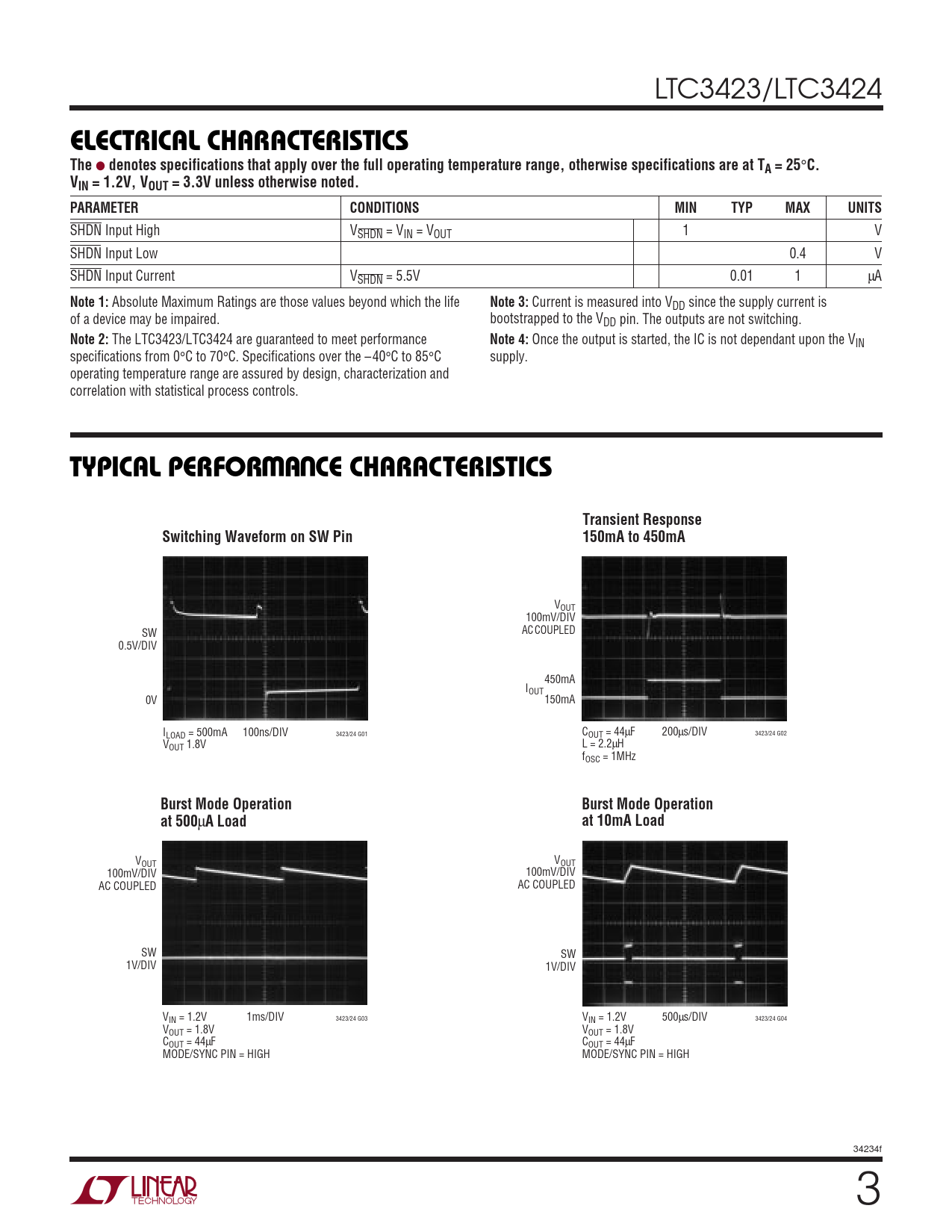

W U TYPICAL PERFOR A CE CHARACTERISTICS Transient Response Switching Waveform on SW Pin 150mA to 450mA
VOUT 100mV/DIV SW AC COUPLED 0.5V/DIV 450mA IOUT 0V 150mA ILOAD = 500mA 100ns/DIV 3423/24 G01 COUT = 44µF 200µs/DIV 3423/24 G02 VOUT 1.8V L = 2.2µH fOSC = 1MHz
Burst Mode Operation Burst Mode Operation at 500
µ
A Load at 10mA Load
VOUT VOUT 100mV/DIV 100mV/DIV AC COUPLED AC COUPLED SW SW 1V/DIV 1V/DIV VIN = 1.2V 1ms/DIV 3423/24 G03 VIN = 1.2V 500µs/DIV 3423/24 G04 VOUT = 1.8V VOUT = 1.8V COUT = 44µF COUT = 44µF MODE/SYNC PIN = HIGH MODE/SYNC PIN = HIGH 34234f 3
