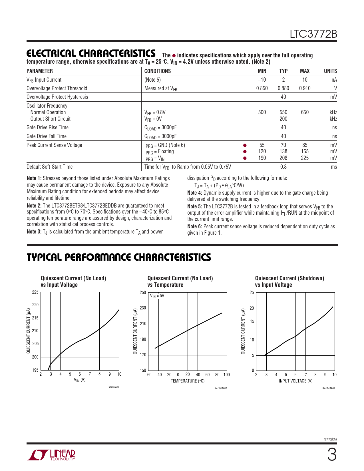

ELECTRICAL CHARACTERISTICS The. indicates specifications which apply over the full operating
ELECTRICAL CHARACTERISTICS The indicates specifications which apply over the full operating
LTC3772B
indicates specifications which apply over the full operating temperature range, otherwise specifications are at TA = 25
C. VIN = 4.2V unless otherwise noted. (Note 2) PARAMETER CONDITIONS MIN TYP MAX UNITS
VFB Input Current (Note 5) –10 2 10 nA Overvoltage Protect Threshold Measured at VFB 0.850 0.880 0.910 V Overvoltage Protect Hysteresis 40 mV Oscillator Frequency Normal Operation VFB = 0.8V 500 550 650 kHz Output Short Circuit VFB = 0V 200 kHz Gate Drive Rise Time CLOAD = 3000pF 40 ns Gate Drive Fall Time CLOAD = 3000pF 40 ns Peak Current Sense Voltage IPRG = GND (Note 6) ● 55 70 85 mV IPRG = Floating ● 120 138 155 mV IPRG = VIN ● 190 208 225 mV Default Soft-Start Time Time for VFB to Ramp from 0.05V to 0.75V 0.8 ms
Note 1:
Stresses beyond those listed under Absolute Maximum Ratings dissipation PD according to the following formula: may cause permanent damage to the device. Exposure to any Absolute TJ = TA + (PD • θJA°C/W) Maximum Rating condition for extended periods may affect device
Note 4:
Dynamic supply current is higher due to the gate charge being reliability and lifetime. delivered at the switching frequency.
Note 2:
The LTC3772BETS8/LTC3772BEDDB are guaranteed to meet
Note 5:
The LTC3772B is tested in a feedback loop that servos VFB to the specifications from 0°C to 70°C. Specifications over the –40°C to 85°C output of the error amplifier while maintaining ITH/RUN at the midpoint of operating temperature range are assured by design, characterization and the current limit range. correlation with statistical process controls.
Note 6:
Peak current sense voltage is reduced dependent on duty cycle as
Note 3:
TJ is calculated from the ambient temperature TA and power given in Figure 1.
W U TYPICAL PERFOR A CE CHARACTERISTICS Quiescent Current (No Load) Quiescent Current (No Load) Quiescent Current (Shutdown) vs Input Voltage vs Temperature vs Input Voltage
