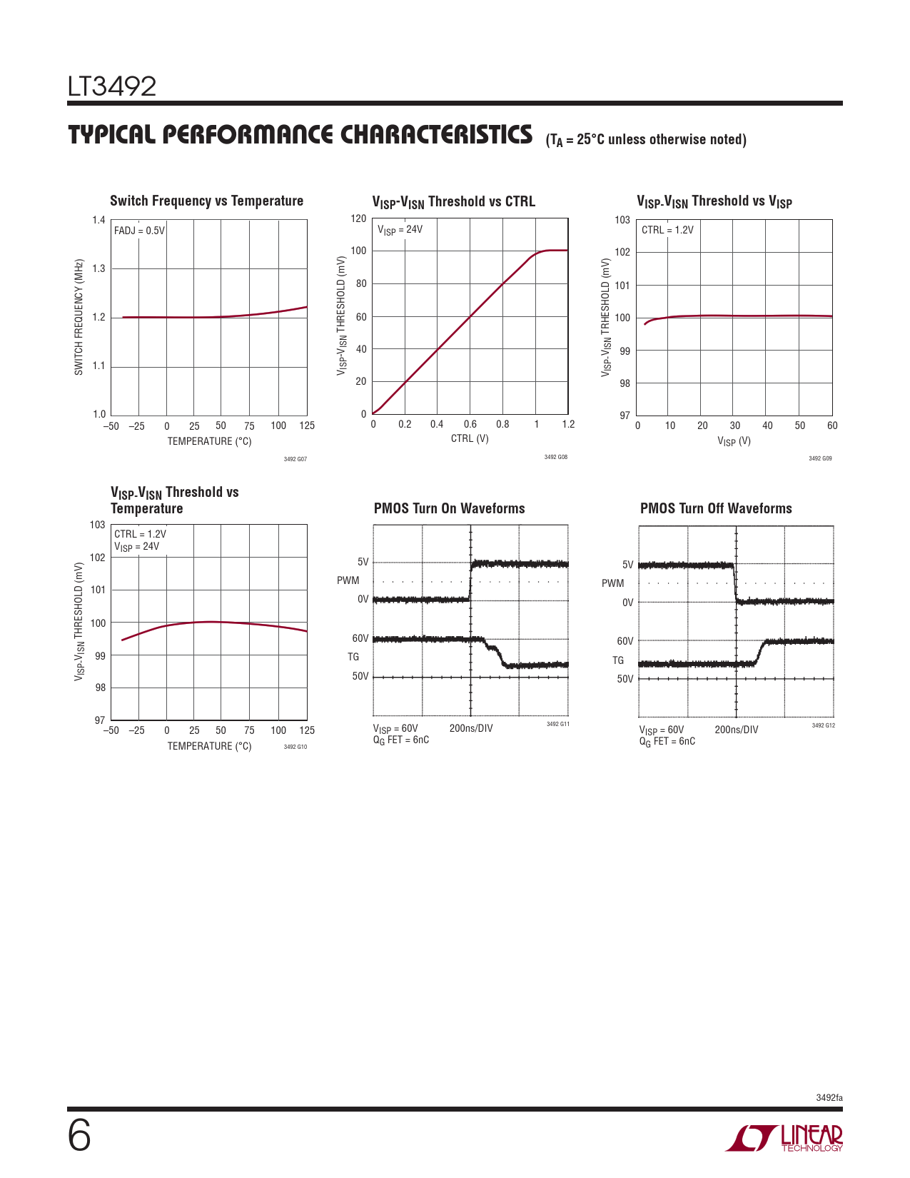

TYPICAL PERFORMANCE CHARACTERISTICS (TA = 25°C unless otherwise noted). Switch Frequency vs Temperature
TYPICAL PERFORMANCE CHARACTERISTICS (TA = 25°C unless otherwise noted) Switch Frequency vs Temperature
LT3492
TYPICAL PERFORMANCE CHARACTERISTICS (TA = 25°C unless otherwise noted) Switch Frequency vs Temperature VISP-VISN Threshold vs CTRL VISP-VISN Threshold vs VISP
1.4 120 103 FADJ = 0.5V VISP = 24V CTRL = 1.2V 100 102 1.3 80 101 1.2 60 100 THRESHOLD (mV) TRHESHOLD (mV) ISN ISN -V 40 V 99 1.1 ISP SWITCH FREQUENCY (MHz) V ISP-V 20 98 1.0 0 97 –50 –25 0 25 50 75 100 125 0 0.2 0.4 0.6 0.8 1 1.2 0 10 20 30 40 50 60 CTRL (V) TEMPERATURE (°C) VISP (V) 3492 G08 3492 G07 3492 G09
VISP-VISN Threshold vs Temperature PMOS Turn On Waveforms PMOS Turn Off Waveforms
