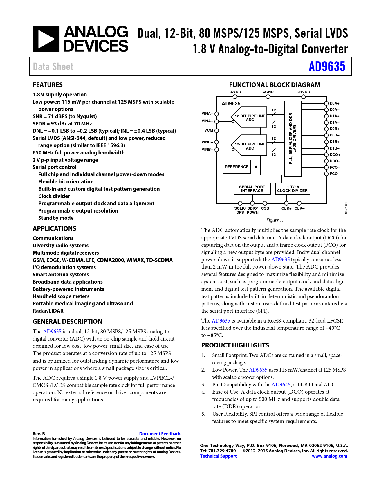

Dual, 12-Bit, 80 MSPS/125 MSPS, Serial LVDS. 1.8 V Analog-to-Digital Converter. Data Sheet. AD9635. FEATURES
Dual, 12-Bit, 80 MSPS/125 MSPS, Serial LVDS 1.8 V Analog-to-Digital Converter Data Sheet AD9635 FEATURES FUNCTIONAL BLOCK DIAGRAM 1.8 V supply operation AVDD AGND DRVDD Low power: 115 mW per channel at 125 MSPS with scalable AD9635 D0A+ power options 12 D0A– SNR = 71 dBFS (to Nyquist) VINA+ 12-BIT PIPELINE D1A+ ADC SFDR = 93 dBc at 70 MHz VINA– D1A– 12 DNL = −0.1 LSB to +0.2 LSB (typical); INL = ±0.4 LSB (typical) RS D0B+ VCM E R AND DDR V Serial LVDS (ANSI-644, default) and low power, reduced E D0B– 12 IZ DRI D1B+ range option (similar to IEEE 1596.3) VINB+ 12-BIT PIPELINE AL ADC RI DS D1B– V 650 MHz full power analog bandwidth VINB– E L 12 DCO+ , S 2 V p-p input voltage range L L DCO– P Serial port control REFERENCE FCO+ Full chip and individual channel power-down modes FCO– Flexible bit orientation Built-in and custom digital test pattern generation SERIAL PORT 1 TO 8 INTERFACE CLOCK DIVIDER Clock divider Programmable output clock and data alignment
001
Programmable output resolution SCLK/ SDIO/ CSB CLK+ CLK– DFS PDWN
10577-
Standby mode
Figure 1.
APPLICATIONS
The ADC automatically multiplies the sample rate clock for the
Communications
appropriate LVDS serial data rate. A data clock output (DCO) for
Diversity radio systems
capturing data on the output and a frame clock output (FCO) for
Multimode digital receivers
signaling a new output byte are provided. Individual channel
GSM, EDGE, W-CDMA, LTE, CDMA2000, WiMAX, TD-SCDMA
power-down is supported; the AD9635 typical y consumes less
I/Q demodulation systems
than 2 mW in the full power-down state. The ADC provides
Smart antenna systems
several features designed to maximize flexibility and minimize
Broadband data applications
system cost, such as programmable output clock and data align-
Battery-powered instruments
ment and digital test pattern generation. The available digital
Handheld scope meters
test patterns include built-in deterministic and pseudorandom
Portable medical imaging and ultrasound
patterns, along with custom user-defined test patterns entered via
Radar/LIDAR
the serial port interface (SPI).
GENERAL DESCRIPTION
The AD9635 is available in a RoHS-compliant, 32-lead LFCSP. The AD9635 is a dual, 12-bit, 80 MSPS/125 MSPS analog-to- It is specified over the industrial temperature range of −40°C digital converter (ADC) with an on-chip sample-and-hold circuit to +85°C. designed for low cost, low power, small size, and ease of use.
PRODUCT HIGHLIGHTS
The product operates at a conversion rate of up to 125 MSPS 1. Small Footprint. Two ADCs are contained in a smal , space- and is optimized for outstanding dynamic performance and low saving package. power in applications where a small package size is critical. 2. Low Power. The AD9635 uses 115 mW/channel at 125 MSPS The ADC requires a single 1.8 V power supply and LVPECL-/ with scalable power options. CMOS-/LVDS-compatible sample rate clock for ful performance 3. Pin Compatibility with the AD9645, a 14-Bit Dual ADC. operation. No external reference or driver components are 4. Ease of Use. A data clock output (DCO) operates at required for many applications. frequencies of up to 500 MHz and supports double data rate (DDR) operation. 5. User Flexibility. SPI control offers a wide range of flexible features to meet specific system requirements.
