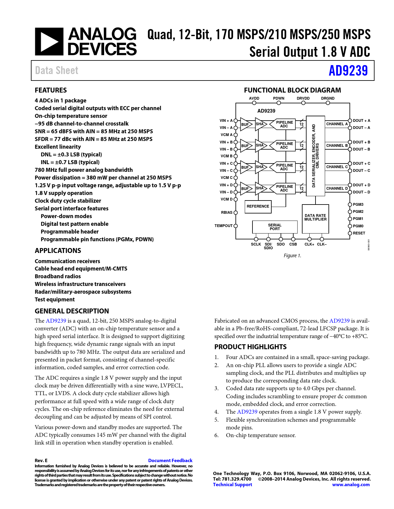

Quad, 12-Bit, 170 MSPS/210 MSPS/250 MSPS. Serial Output 1.8 V ADC. Data Sheet. AD9239. FEATURES. FUNCTIONAL BLOCK DIAGRAM
Datasheet AD9239 Analog Devices, Revision: E
Quad, 12-Bit, 170 MSPS/210 MSPS/250 MSPS Serial Output 1.8 V ADC Data Sheet AD9239 FEATURES FUNCTIONAL BLOCK DIAGRAM 4 ADCs in 1 package AVDD PDWN DRVDD DRGND Coded serial digital outputs with ECC per channel AD9239 On-chip temperature sensor −95 dB channel-to-channel crosstalk VIN + A DOUT + A PIPELINE BUF SHA 12 CHANNEL A ADC VIN – A DOUT – A SNR = 65 dBFS with AIN = 85 MHz at 250 MSPS AND VCM A R, SFDR = 77 dBc with AIN = 85 MHz at 250 MSPS VIN + B DE DOUT + B Excellent linearity PIPELINE BUF SHA 12 CHANNEL B ADC RS VIN – B NCO E DOUT – B DNL = ±0.3 LSB (typical) E V VCM B R, E INL = ±0.7 LSB (typical) DRI IZ L VIN + C DOUT + C PIPELINE 780 MHz full power analog bandwidth BUF SHA 12 AL CM CHANNEL C ADC VIN – C RI DOUT – C E Power dissipation = 380 mW per channel at 250 MSPS VCM C A S 1.25 V p-p input voltage range, adjustable up to 1.5 V p-p VIN + D DOUT + D PIPELINE DAT BUF SHA 12 CHANNEL D 1.8 V supply operation ADC VIN – D DOUT – D Clock duty cycle stabilizer VCM D PGM3 Serial port interface features REFERENCE PGM2 RBIAS Power-down modes DATA RATE MULTIPLIER PGM1 Digital test pattern enable TEMPOUT SERIAL PGM0 Programmable header PORT RESET Programmable pin functions (PGMx, PDWN)

06980- Figure 1.
