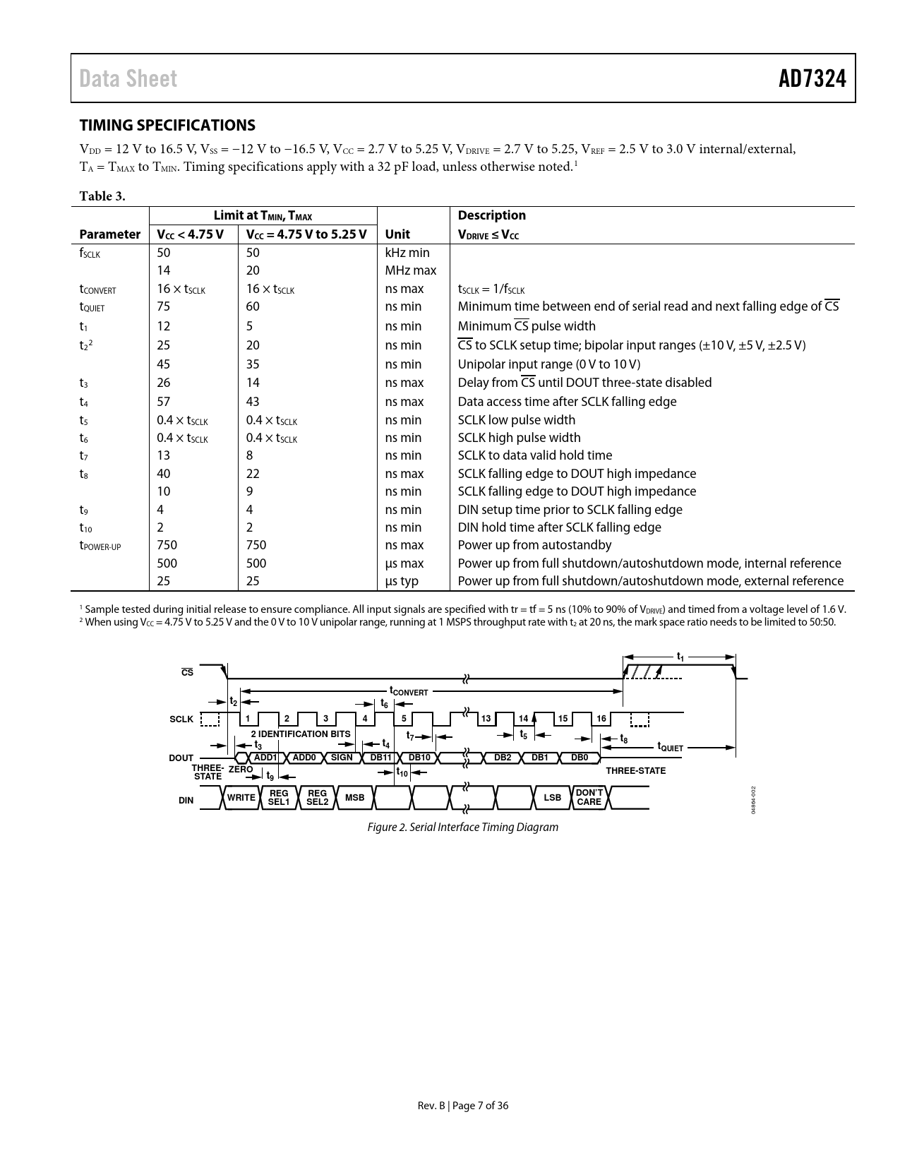

Data Sheet AD7324 TIMING SPECIFICATIONS
VDD = 12 V to 16.5 V, VSS = −12 V to −16.5 V, VCC = 2.7 V to 5.25 V, VDRIVE = 2.7 V to 5.25, VREF = 2.5 V to 3.0 V internal/external, TA = TMAX to TMIN. Timing specifications apply with a 32 pF load, unless otherwise noted.1
Table 3. Limit at TMIN, TMAX Description Parameter VCC < 4.75 V VCC = 4.75 V to 5.25 V Unit VDRIVE ≤ VCC
fSCLK 50 50 kHz min 14 20 MHz max tCONVERT 16 × tSCLK 16 × tSCLK ns max tSCLK = 1/fSCLK tQUIET 75 60 ns min Minimum time between end of serial read and next falling edge of CS t1 12 5 ns min Minimum CS pulse width t 2 2 25 20 ns min CS to SCLK setup time; bipolar input ranges (±10 V, ±5 V, ±2.5 V) 45 35 ns min Unipolar input range (0 V to 10 V) t3 26 14 ns max Delay from CS until DOUT three-state disabled t4 57 43 ns max Data access time after SCLK falling edge t5 0.4 × tSCLK 0.4 × tSCLK ns min SCLK low pulse width t6 0.4 × tSCLK 0.4 × tSCLK ns min SCLK high pulse width t7 13 8 ns min SCLK to data valid hold time t8 40 22 ns max SCLK falling edge to DOUT high impedance 10 9 ns min SCLK falling edge to DOUT high impedance t9 4 4 ns min DIN setup time prior to SCLK falling edge t10 2 2 ns min DIN hold time after SCLK falling edge tPOWER-UP 750 750 ns max Power up from autostandby 500 500 µs max Power up from full shutdown/autoshutdown mode, internal reference 25 25 µs typ Power up from full shutdown/autoshutdown mode, external reference 1 Sample tested during initial release to ensure compliance. All input signals are specified with tr = tf = 5 ns (10% to 90% of VDRIVE) and timed from a voltage level of 1.6 V. 2 When using VCC = 4.75 V to 5.25 V and the 0 V to 10 V unipolar range, running at 1 MSPS throughput rate with t2 at 20 ns, the mark space ratio needs to be limited to 50:50.
t1 CS tCONVERT t2 t6 SCLK 1 2 3 4 5 13 14 15 16 2 IDENTIFICATION BITS t t 7 5 t t t 8 4 3 tQUIET DOUT ADD1 ADD0 SIGN DB11 DB10 DB2 DB1 DB0 THREE- ZERO t THREE-STATE STATE t 10 9 REG REG DON’T WRITE MSB LSB
002
DIN SEL1 SEL2 CARE
04864- Figure 2. Serial Interface Timing Diagram Rev. B | Page 7 of 36 Document Outline Features Functional Block Diagram General Description Product Highlights Table of Contents Revision History Specifications Timing Specifications Absolute Maximum Ratings ESD Caution Pin Configuration and Function Description Typical Performance Characteristics Terminology Theory of Operation Circuit Information Converter Operation Output Coding Transfer Functions Analog Input Structure Track-and-Hold Section Typical Connection Diagram Analog Input Single-Ended Inputs True Differential Mode Pseudo Differential Inputs Driver Amplifier Choice Registers Addressing Registers Control Register Sequence Register Range Register Sequencer Operation Reference VDRIVE Modes of Operation Normal Mode Full Shutdown Mode Autoshutdown Mode Autostandby Mode Power vs. Throughput Rate Serial Interface Microprocessor Interfacing AD7324 to ADSP-21xx AD7324 to ADSP-BF53x Application Hints Layout and Grounding Power Supply Configuration Outline Dimensions Ordering Guide
