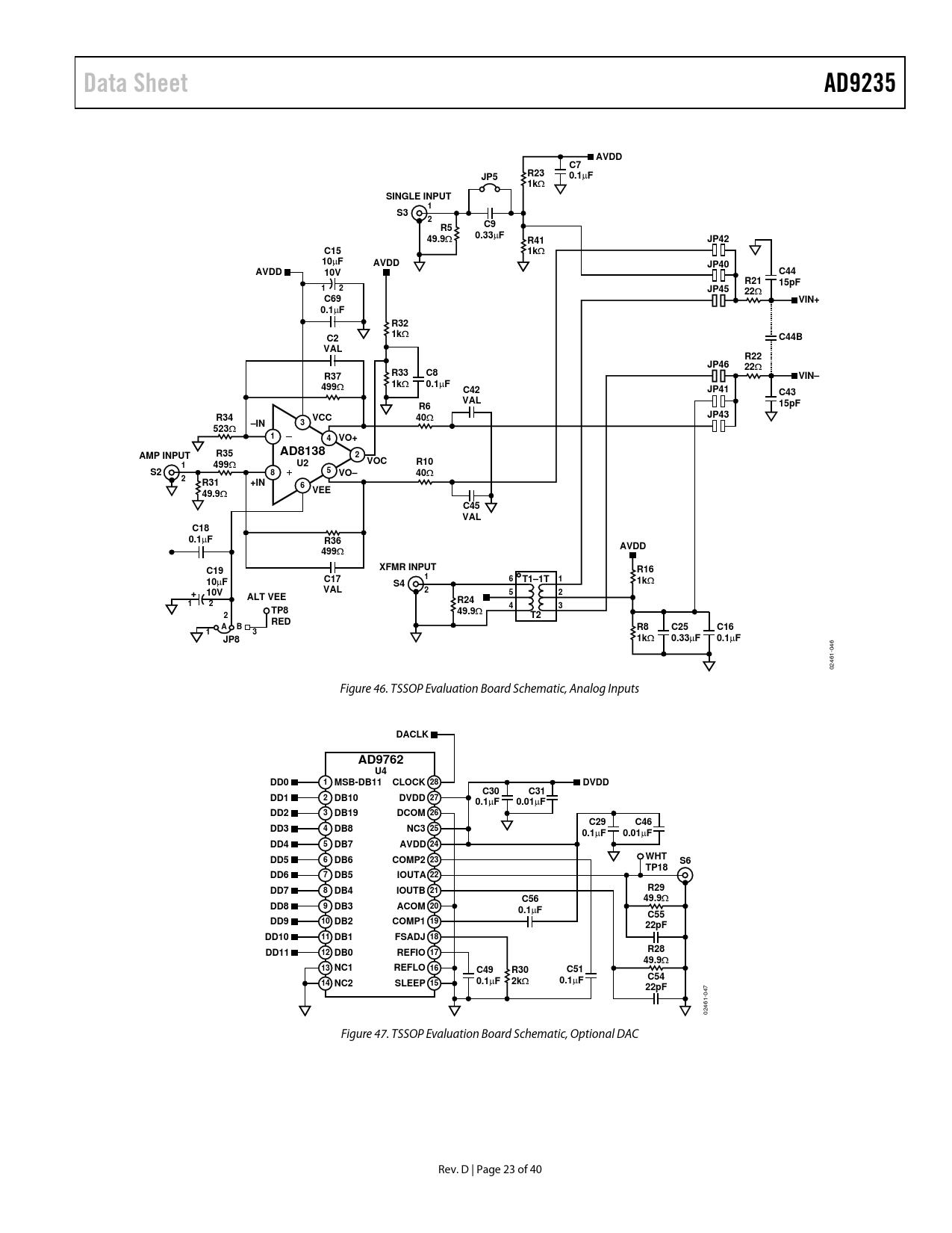

Pages / Page41 / 24 — Data Sheet. AD9235. AVDD. R23. JP5. 0.1. SINGLE INPUT. 0.33. 49.9. R41. …

02461-046 Figure 46. TSSOP Evaluation Board Schematic, Analog Inputs

02461-047 Figure 47. TSSOP Evaluation Board Schematic, Optional DAC Rev. D | Page 23 of 40 Document Outline Specifications DC Specifications Digital Specifications Switching Specifications AC Specifications Absolute Maximum Ratings Explanation of Test Levels ESD Caution Pin Configurations and Function Descriptions Definitions of Specifications Equivalent Circuits Typical Performance Characteristics Applying the AD9235 Theory of Operation Analog Input Differential Input Configurations Single-Ended Input Configuration Clock Input Considerations Power Dissipation and Standby Mode Digital Outputs Timing Voltage Reference Internal Reference Connection External Reference Operation Operational Mode Selection TSSOP Evaluation Board LFCSP Evaluation Board Outline Dimensions Ordering Guide
