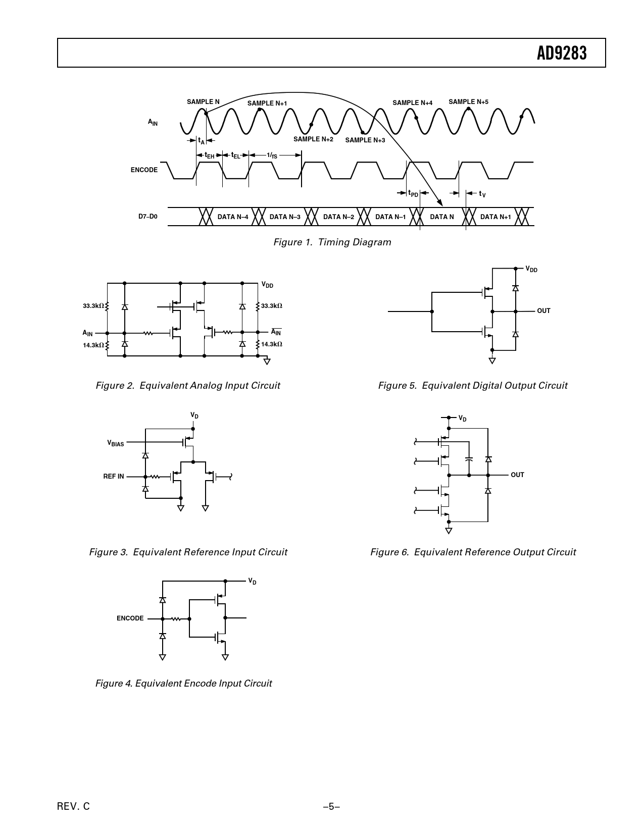

AD9283. SAMPLE N. SAMPLE N+1. SAMPLE N+4. SAMPLE N+5. AIN. SAMPLE N+2. SAMPLE N+3. ENCODE. tPD. t V. D7–D0. DATA N–4. DATA N–3. DATA N–2. DATA N–1
AD9283 SAMPLE N SAMPLE N+1 SAMPLE N+4 SAMPLE N+5 AIN SAMPLE N+2 SAMPLE N+3 ENCODE tPD t V D7–D0 DATA N–4 DATA N–3 DATA N–2 DATA N–1
AD9283 SAMPLE N SAMPLE N+1 SAMPLE N+4 SAMPLE N+5 AIN t SAMPLE N+2 SAMPLE N+3 A t t 1/ EH EL fS ENCODE tPD t V D7–D0 DATA N–4 DATA N–3 DATA N–2 DATA N–1 DATA N DATA N+1
Figure 1. Timing Diagram
VDD VDD 33.3k
33.3k
OUT A A IN IN 14.3k
14.3k
⍀ Figure 2. Equivalent Analog Input Circuit Figure 5. Equivalent Digital Output Circuit
VD VD VBIAS REF IN OUT
Figure 3. Equivalent Reference Input Circuit Figure 6. Equivalent Reference Output Circuit
VD ENCODE
Figure 4. Equivalent Encode Input Circuit REV. C –5–
