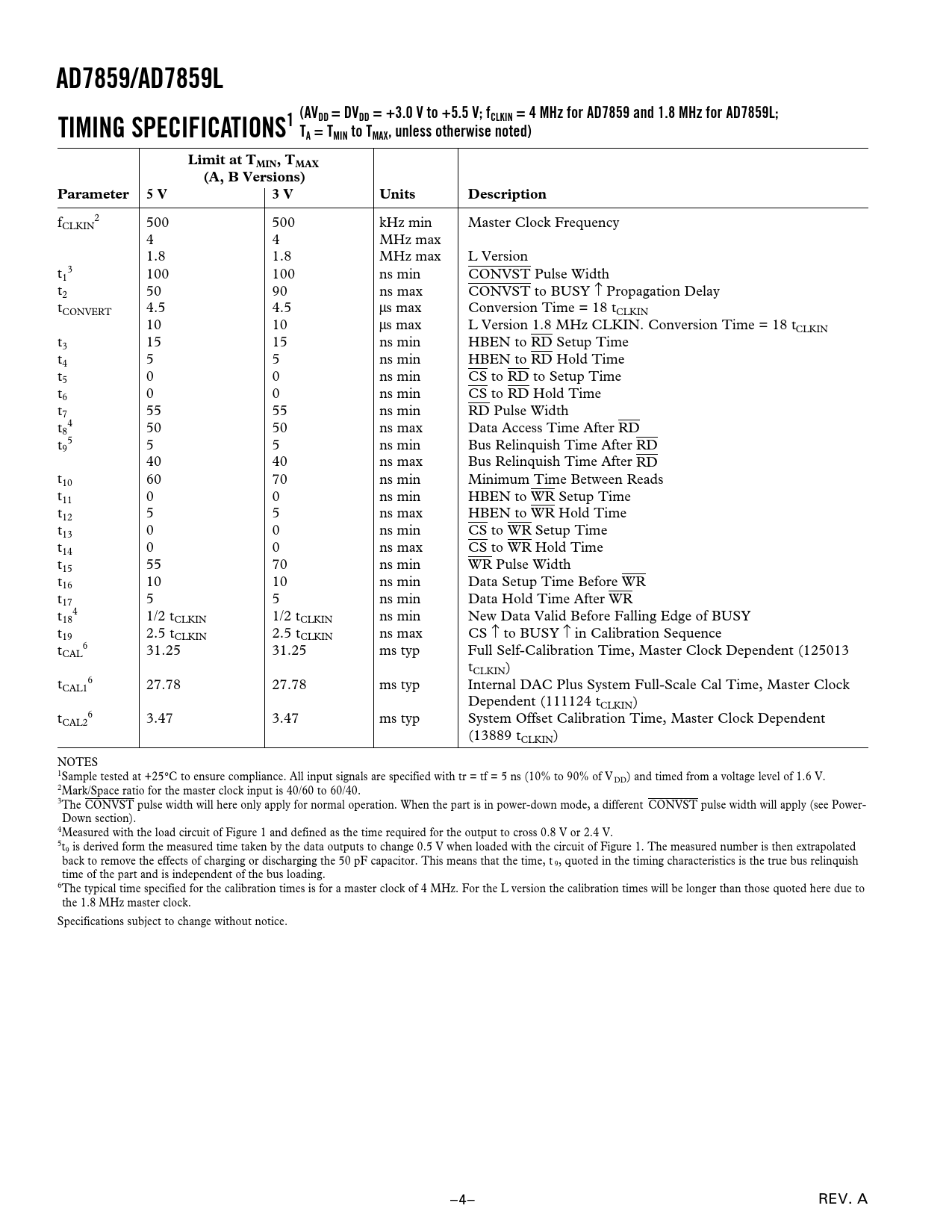

AD7859/AD7859L TIMING SPECIFICATIONS1 (AVDD = DVDD = +3.0 V to +5.5 V; fCLKIN = 4 MHz for AD7859 and 1.8 MHz for AD7859L; TA = TMIN to TMAX, unless otherwise noted) Limit at TMIN, TMAX (A, B Versions) Parameter 5 V 3 V Units Description
