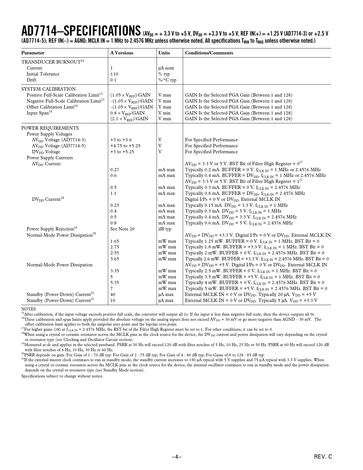

AD7714–SPECIFICATIONS (AVDD = + 3.3␣V to +5␣V, DVDD = +3.3␣V to +5␣V, REF IN(+) = +1.25␣V (AD7714-3) or +2.5␣ V
AD7714–SPECIFICATIONS (AVDD = + 3.3␣V to +5␣V, DVDD = +3.3␣V to +5␣V, REF IN(+) = +1.25␣V (AD7714-3) or +2.5␣ V (AD7714-5); REF␣ IN(–) = AGND; MCLK␣ IN = 1␣ MHz to 2.4576␣ MHz unless otherwise noted. All specifications TMIN to TMAX unless otherwise noted.) Parameter A Versions Units Conditions/Comments
TRANSDUCER BURNOUT14 Current 1 µA nom Initial Tolerance ±10 % typ Drift 0.1 %/°C typ SYSTEM CALIBRATION Positive Full-Scale Calibration Limit15 (1.05 × VREF)/GAIN V max GAIN Is the Selected PGA Gain (Between 1 and 128) Negative Full-Scale Calibration Limit15 –(1.05 × VREF)/GAIN V max GAIN Is the Selected PGA Gain (Between 1 and 128) Offset Calibration Limit16 –(1.05 × VREF)/GAIN V max GAIN Is the Selected PGA Gain (Between 1 and 128) Input Span16 0.8 × VREF/GAIN V min GAIN Is the Selected PGA Gain (Between 1 and 128) (2.1 × VREF)/GAIN V max GAIN Is the Selected PGA Gain (Between 1 and 128) POWER REQUIREMENTS Power Supply Voltages AVDD Voltage (AD7714-3) +3 to +3.6 V For Specified Performance AVDD Voltage (AD7714-5) +4.75 to +5.25 V For Specified Performance DVDD Voltage +3 to +5.25 V For Specified Performance Power Supply Currents AVDD Current AVDD = 3.3␣ V or 5␣ V. BST Bit of Filter High Register = 017 0.27 mA max Typically 0.2 mA. BUFFER = 0 V. fCLK IN = 1␣ MHz or 2.4576␣ MHz 0.6 mA max Typically 0.4 mA. BUFFER = DVDD. fCLK IN = 1␣ MHz or 2.4576␣ MHz AVDD = 3.3␣ V or 5␣ V. BST Bit of Filter High Register = 117 0.5 mA max Typically 0.3␣ mA. BUFFER = 0␣ V. fCLK IN = 2.4576␣ MHz 1.1 mA max Typically 0.8␣ mA. BUFFER = DVDD. fCLK IN = 2.4576␣ MHz DVDD Current18 Digital I/Ps = 0␣ V or DVDD. External MCLK IN 0.23 mA max Typically 0.15␣ mA. DVDD = 3.3␣ V. fCLK IN = 1␣ MHz 0.4 mA max Typically 0.3␣ mA. DVDD = 5␣ V. fCLK IN = 1␣ MHz 0.5 mA max Typically 0.4␣ mA. DVDD = 3.3␣ V. fCLK IN = 2.4576␣ MHz 0.8 mA max Typically 0.6␣ mA. DVDD = 5␣ V. fCLK IN = 2.4576␣ MHz Power Supply Rejection19 See Note 20 dB typ Normal-Mode Power Dissipation18 AVDD = DVDD = +3.3␣ V. Digital I/Ps = 0␣ V or DVDD. External MCLK IN 1.65 mW max Typically 1.25␣ mW. BUFFER = 0␣ V. fCLK IN = 1␣ MHz. BST Bit = 0 2.75 mW max Typically 1.8␣ mW. BUFFER = +3.3␣ V. fCLK IN = 1␣ MHz. BST Bit = 0 2.55 mW max Typically 2␣ mW. BUFFER = 0␣ V. fCLK IN = 2.4576␣ MHz. BST Bit = 0 3.65 mW max Typically 2.6␣ mW. BUFFER = +3.3␣ V. fCLK IN = 2.4576␣ MHz. BST Bit = 0 Normal-Mode Power Dissipation AVDD = DVDD = +5␣ V. Digital I/Ps = 0␣ V or DVDD. External MCLK IN 3.35 mW max Typically 2.5␣ mW. BUFFER = 0␣ V. fCLK IN = 1␣ MHz. BST Bit = 0 5 mW max Typically 3.5␣ mW. BUFFER = +5␣ V. fCLK IN = 1␣ MHz. BST Bit = 0 5.35 mW max Typically 4␣ mW. BUFFER = 0␣ V. fCLK IN = 2.4576␣ MHz. BST Bit = 0 7 mW max Typically 5␣ mW. BUFFER = +5␣ V. fCLK IN = 2.4576␣ MHz. BST Bit = 0 Standby (Power-Down) Current21 40 µA max External MCLK IN = 0 V or DVDD. Typically 20␣ µA. VDD = +5 V Standby (Power-Down) Current21 10 µA max External MCLK IN = 0 V or DVDD. Typically 5␣ µA. VDD = +3.3 V NOTES 15After calibration, if the input voltage exceeds positive full scale, the converter will output all 1s. If the input is less than negative full scale, then the device outputs all 0s. 16These calibration and span limits apply provided the absolute voltage on the analog inputs does not exceed AVDD + 30␣ mV or go more negative than AGND␣ –␣ 30␣ mV. The offset calibration limit applies to both the unipolar zero point and the bipolar zero point. 17For higher gains (≥8) at fCLK␣ IN = 2.4576␣ MHz, the BST bit of the Filter High Register must be set to 1. For other conditions, it can be set to 0. 18When using a crystal or ceramic resonator across the MCLK pins as the clock source for the device, the DVDD current and power dissipation will vary depending on the crystal or resonator type (see Clocking and Oscillator Circuit section). 19Measured at dc and applies in the selected passband. PSRR at 50 Hz will exceed 120 dB with filter notches of 5 Hz, 10 Hz, 25 Hz or 50 Hz. PSRR at 60 Hz will exceed 120 dB with filter notches of 6 Hz, 10 Hz, 30 Hz or 60 Hz. 20PSRR depends on gain. For Gain of 1 : 70 dB typ: For Gain of 2 : 75 dB typ; For Gain of 4 : 80 dB typ; For Gains of 8 to 128 : 85 dB typ. 21If the external master clock continues to run in standby mode, the standby current increases to 150 µA typical with 5 V supplies and 75 µA typical with 3.3 V supplies. When using a crystal or ceramic resonator across the MCLK pins as the clock source for the device, the internal oscillator continues to run in standby mode and the power dissipation depends on the crystal or resonator type (see Standby Mode section). Specifications subject to change without notice. –4– REV. C
