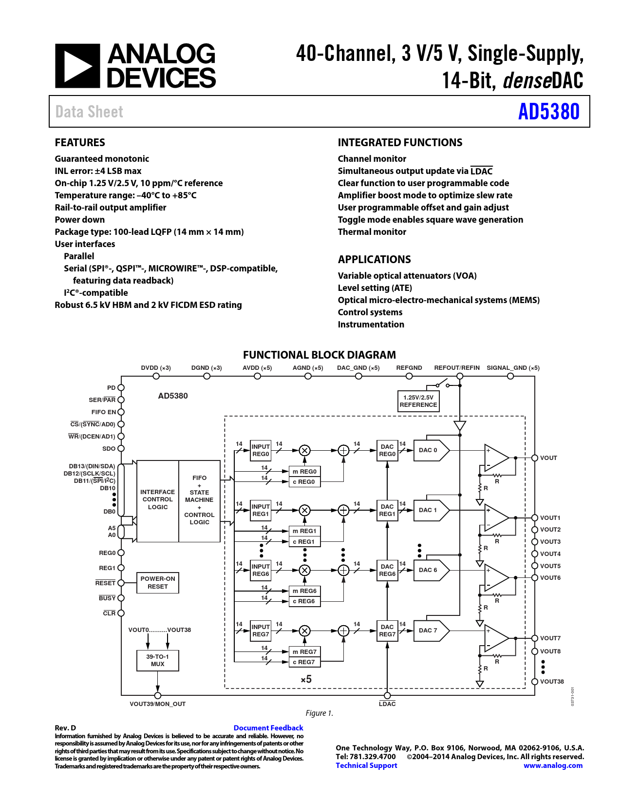

40-Channel, 3 V/5 V, Single-Supply,. 14-Bit, dense. DAC. Data Sheet. AD5380. FEATURES. INTEGRATED FUNCTIONS. Guaranteed monotonic
Datasheet AD5380 Analog Devices, Revision: D
40-Channel, 3 V/5 V, Single-Supply, 14-Bit, dense DAC Data Sheet AD5380 FEATURES INTEGRATED FUNCTIONS Guaranteed monotonic Channel monitor INL error: ±4 LSB max Simultaneous output update via LDAC On-chip 1.25 V/2.5 V, 10 ppm/°C reference Clear function to user programmable code Temperature range: –40°C to +85°C Amplifier boost mode to optimize slew rate Rail-to-rail output amplifier User programmable offset and gain adjust Power down Toggle mode enables square wave generation Package type: 100-lead LQFP (14 mm × 14 mm) Thermal monitor User interfaces Parallel APPLICATIONS Serial (SPI®-, QSPI™-, MICROWIRE™-, DSP-compatible, Variable optical attenuators (VOA) featuring data readback) Level setting (ATE) I2C®-compatible Optical micro-electro-mechanical systems (MEMS) Robust 6.5 kV HBM and 2 kV FICDM ESD rating Control systems Instrumentation FUNCTIONAL BLOCK DIAGRAM DVDD (×3) DGND (×3) AVDD (×5) AGND (×5) DAC_GND (×5) REFGND REFOUT/REFIN SIGNAL_GND (×5) PD AD5380 1.25V/2.5V SER/PAR REFERENCE FIFO EN CS/(SYNC/AD0) WR/(DCEN/AD1) 14 14 14 14 INPUT DAC SDO DAC 0 REG0 REG0 VOUT DB13/(DIN/SDA) 14 m REG0 DB12/(SCLK/SCL) FIFO 14 DB11/(SPI/I2C) c REG0 R + DB10 R INTERFACE STATE CONTROL MACHINE 14 14 14 14 LOGIC + INPUT DAC DAC 1 DB0 CONTROL REG1 REG1 VOUT1 LOGIC A5 14 VOUT2 m REG1 A0 14 c REG1 R VOUT3 R REG0 VOUT4 14 14 14 14 INPUT DAC VOUT5 REG1 DAC 6 REG6 REG6 POWER-ON VOUT6 RESET RESET 14 m REG6 BUSY 14 c REG6 R R CLR 14 14 14 14 INPUT DAC VOUT0………VOUT38 DAC 7 REG7 REG7 VOUT7 14 m REG7 VOUT8 39-TO-1 14 MUX c REG7 R R ×5 VOUT38

037 Figure 1.
