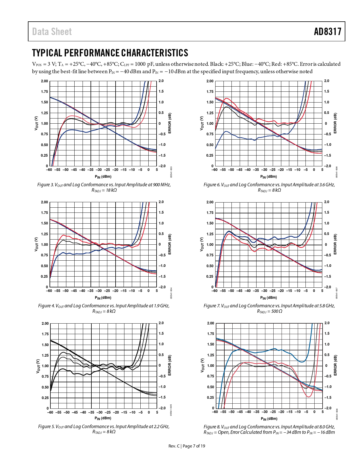

Data Sheet. AD8317. TYPICAL PERFORMANCE CHARACTERISTICS. 2.00. 2.0. 1.75. 1.5. 1.50. 1.0. 1.25. 0.5. (V). 1.00. R (. RRO. 0.75. –0.5. 0.50. –1.0. 0.25. –1.5
Data Sheet AD8317 TYPICAL PERFORMANCE CHARACTERISTICS
VPOS = 3 V; TA = +25°C, −40°C, +85°C; CLPF = 1000 pF, unless otherwise noted. Black: +25°C; Blue: −40°C; Red: +85°C. Error is calculated by using the best-fit line between PIN = −40 dBm and PIN = −10 dBm at the specified input frequency, unless otherwise noted

05541- Figure 3. VOUT and Log Conformance vs. Input Amplitude at 900 MHz, Figure 6. VOUT and Log Conformance vs. Input Amplitude at 3.6 GHz, RTADJ = 18 kΩ RTADJ = 8 kΩ

05541- Figure 4. VOUT and Log Conformance vs. Input Amplitude at 1.9 GHz, Figure 7. VOUT and Log Conformance vs. Input Amplitude at 5.8 GHz, RTADJ = 8 kΩ RTADJ = 500 Ω

05541- Figure 5. VOUT and Log Conformance vs. Input Amplitude at 2.2 GHz, Figure 8. VOUT and Log Conformance vs. Input Amplitude at 8.0 GHz, RTADJ = 8 kΩ RTADJ = Open, Error Calculated from PIN = −34 dBm to PIN = −16 dBm Rev. C | Page 7 of 19 Document Outline FEATURES APPLICATIONS FUNCTIONAL BLOCK DIAGRAM GENERAL DESCRIPTION TABLE OF CONTENTS REVISION HISTORY SPECIFICATIONS ABSOLUTE MAXIMUM RATINGS ESD CAUTION PIN CONFIGURATION AND FUNCTION DESCRIPTIONS TYPICAL PERFORMANCE CHARACTERISTICS THEORY OF OPERATION USING THE AD8317 BASIC CONNECTIONS INPUT SIGNAL COUPLING OUTPUT INTERFACE SETPOINT INTERFACE TEMPERATURE COMPENSATION OF OUTPUT VOLTAGE MEASUREMENT MODE SETTING THE OUTPUT SLOPE IN MEASUREMENT MODE CONTROLLER MODE OUTPUT FILTERING OPERATION BEYOND 8 GHz EVALUATION BOARD DIE INFORMATION OUTLINE DIMENSIONS ORDERING GUIDE
