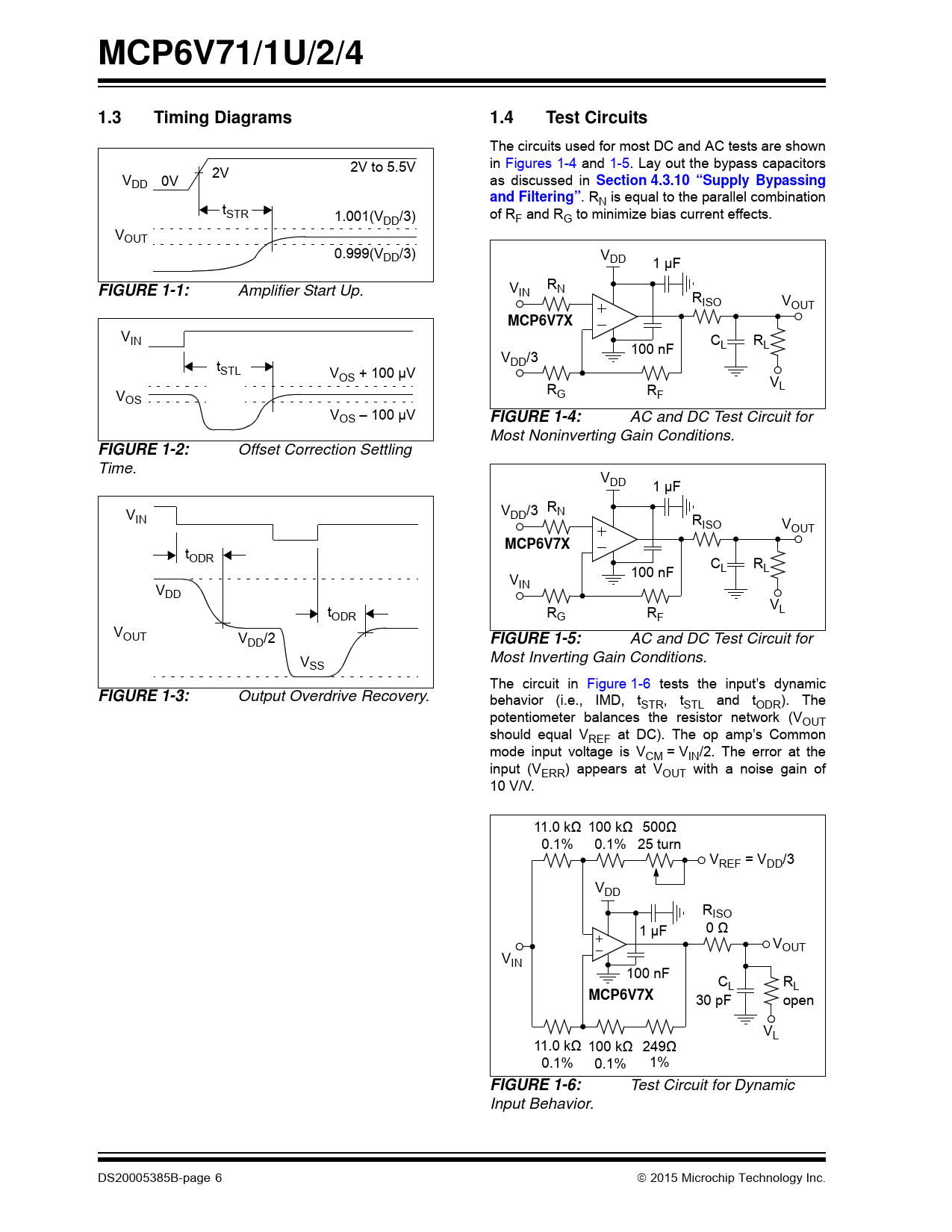

MCP6V71/1U/2/4 1.3 Timing Diagrams 1.4 Test Circuits
The circuits used for most DC and AC tests are shown in Figures 1-4 and 1-5. Lay out the bypass capacitors 2V to 5.5V V 2V 0V as discussed in
Section 4.3.10 “Supply Bypassing
DD
and Filtering”
. RN is equal to the parallel combination tSTR 1.001(V of R DD/3) F and RG to minimize bias current effects. VOUT 0.999(VDD/3) VDD 1 µF R
FIGURE 1-1:
Amplifier Start Up. V N IN RISO VOUT
MCP6V7X
VIN CL RL 100 nF V t DD/3 STL VOS + 100 µV VL V RG R OS F VOS – 100 µV
FIGURE 1-4:
AC and DC Test Circuit for Most Noninverting Gain Conditions.
FIGURE 1-2:
Offset Correction Settling Time. VDD 1 µF R V V N IN DD/3 RISO VOUT
MCP6V7X
tODR CL RL 100 nF V V IN DD t VL ODR RG RF VOUT VDD/2
FIGURE 1-5:
AC and DC Test Circuit for Most Inverting Gain Conditions. VSS The circuit in Figure 1-6 tests the input’s dynamic
FIGURE 1-3:
Output Overdrive Recovery. behavior (i.e., IMD, tSTR, tSTL and tODR). The potentiometer balances the resistor network (VOUT should equal VREF at DC). The op amp’s Common mode input voltage is VCM = VIN/2. The error at the input (VERR) appears at VOUT with a noise gain of 10 V/V. 11.0 kΩ 100 kΩ 500Ω 0.1% 0.1% 25 turn VREF = VDD/3 VDD RISO 1 µF 0 Ω VOUT VIN 100 nF CL RL
MCP6V7X
30 pF open VL 11.0 kΩ 100 kΩ 249Ω 0.1% 0.1% 1%
FIGURE 1-6:
