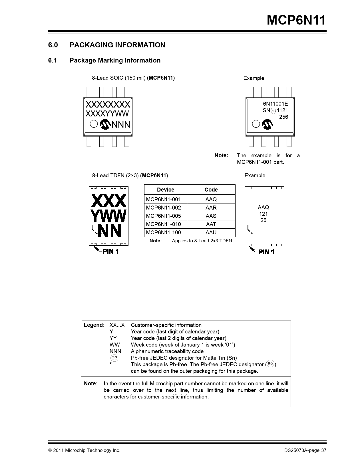

MCP6N11. 6.0. PACKAGING INFORMATION. 6.1. Package Marking Information. (MCP6N11). Note:. Device. Code. Legend:. Note
MCP6N11 6.0 PACKAGING INFORMATION 6.1 Package Marking Information (MCP6N11) Note: Device Code Legend: Note
8-Lead SOIC (150 mil)
(MCP6N11)
Example 6N11001E SN^^ 1 e3 121 256 NNN
Note:
The example is for a MCP6N11-001 part. 8-Lead TDFN (2×3)
(MCP6N11)
Example
Device Code
MCP6N11-001 AAQ MCP6N11-002 AAR AAQ MCP6N11-005 AAS 121 25 MCP6N11-010 AAT MCP6N11-100 AAU
Note:
Applies to 8-Lead 2x3 TDFN
Legend:
XX...X Customer-specific information Y Year code (last digit of calendar year) YY Year code (last 2 digits of calendar year) WW Week code (week of January 1 is week ‘01’) NNN Alphanumeric traceability code e3 Pb-free JEDEC designator for Matte Tin (Sn)
This package is Pb-free. The Pb-free JEDEC designator ( ) e3 can be found on the outer packaging for this package.
