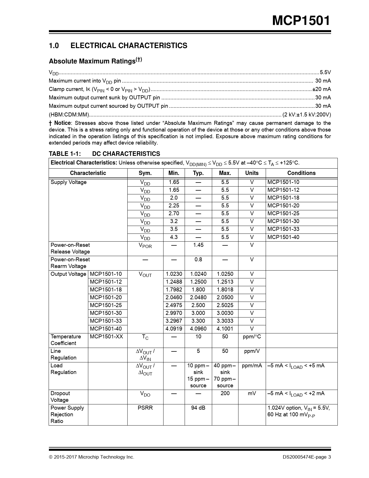

MCP1501. 1.0 ELECTRICAL CHARACTERISTICS Absolute Maximum Ratings(†). VDD.5.5V. Maximum current into VDD pin . 30 mA
MCP1501 1.0 ELECTRICAL CHARACTERISTICS Absolute Maximum Ratings(†) VDD.5.5V Maximum current into VDD pin  30 mA
MCP1501
VDD.5.5V
Clamp current, IK (VPIN < 0 or VPIN > VDD). ±20 mA
Maximum output current sunk by OUTPUT pin .30 mA
Maximum output current sourced by OUTPUT pin .30 mA
(HBM:CDM:MM). (2 kV:±1.5 kV:200V)

extended periods may affect device reliability. TABLE 1-1: DC CHARACTERISTICS Electrical Characteristics: Unless otherwise specified, VDD(MIN) VDD  5.5V at –40C  TA  +125C.
Characteristic
Supply Voltage Power-on-Reset
Release Voltage
Power-on-Reset
Rearm Voltage
Output Voltage MCP1501-10
MCP1501-12
MCP1501-18
MCP1501-20
MCP1501-25
MCP1501-30
MCP1501-33
MCP1501-40
Temperature
MCP1501-XX
Coefficient
Line
Regulation
Load
Regulation Dropout
Voltage
Power Supply
Rejection
Ratio  2015-2017 Microchip Technology Inc. Sym. Min. Typ. Max. Units VDD
VDD
VDD
VDD
VDD
VDD
VDD
VDD
VPOR 1.65
1.65
2.0
2.25
2.70
3.2
3.5
4.3
1.45 5.5
5.5
5.5
5.5
5.5
5.5
5.5
5.5
— V
V
V
V
V
V
V
V
V — — 0.8 — V VOUT 1.0230
1.2488
1.7982
2.0460
2.4975
2.9970
3.2967
4.0919
— 1.0240
1.2500
1.800
2.0480
2.500
3.000
3.300
4.0960
10 1.0250
1.2513
1.8018
2.0500
2.5025
3.0030
3.3033
4.1001
50 V
V
V
V
V
V
V
V
ppm/C VOUT /
VIN
VOUT /
IOUT — 5 50 ppm/V VDO — TC PSRR — 10 ppm – 40 ppm –
sink
sink
15 ppm – 70 ppm –
source
source
200
94 dB Conditions
MCP1501-10
MCP1501-12
MCP1501-18
MCP1501-20
MCP1501-25
MCP1501-30
MCP1501-33
MCP1501-40 ppm/mA –5 mA < ILOAD < +5 mA mV –5 mA < ILOAD < +2 mA
1.024V option, VIN = 5.5V,
60 Hz at 100 mVP-P DS20005474E-page 3
