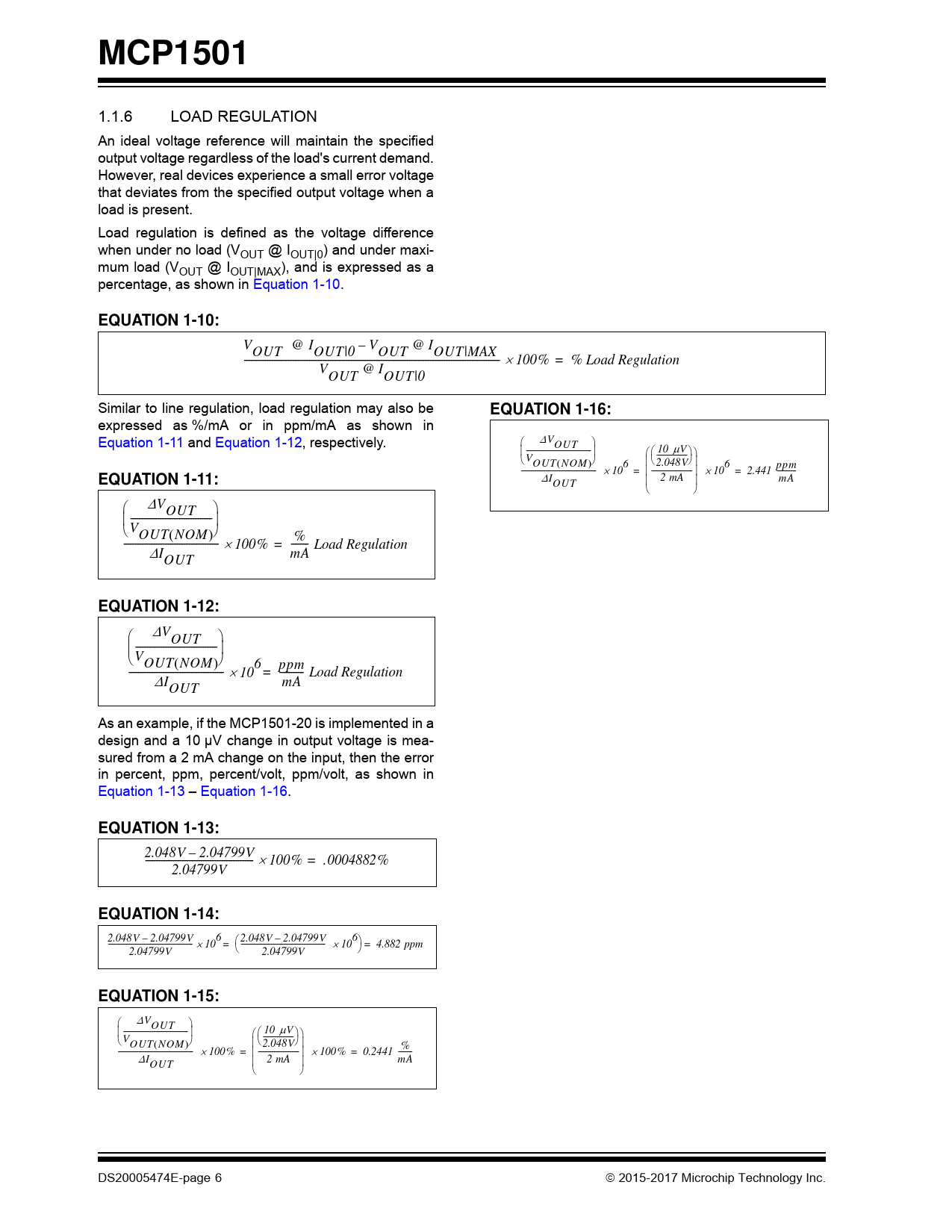

MCP1501. 1.1.6 LOAD REGULATION An ideal voltage reference will maintain the specified
MCP1501 1.1.6 LOAD REGULATION An ideal voltage reference will maintain the specified
MCP1501
output voltage regardless of the load's current demand.
However, real devices experience a small error voltage
that deviates from the specified output voltage when a
load is present.
Load regulation is defined as the voltage difference
when under no load (VOUT @ IOUT|0) and under maximum load (VOUT @ IOUT|MAX), and is expressed as a
percentage, as shown in Equation 1-10. EQUATION 1-10:
V OUT @ I OUT|0 – V OUT @ I OUT|MAX
---------------------------- 100% = % Load Regulation
V OUT @ I OUT|0
Similar to line regulation, load regulation may also be
expressed as %/mA or in ppm/mA as shown in
Equation 1-11 and Equation 1-12, respectively. EQUATION 1-11:
  V OUT 
 V OUT  NOM 
----------- 100% = --Load Regulation
 I OUT
mA EQUATION 1-16:
  V OUT 
10  V- 
  ---- V OUT  NOM 
  2.048V 
6
6
----------- 10 =  ------  10 = 2.441 ppm
--- I OUT
mA
 2 mA 
 EQUATION 1-12:
  V OUT 
 V OUT  NOM 
6 ppm
----------- 10 = ---Load Regulation
 I OUT
mA
As an example, if the MCP1501-20 is implemented in a
design and a 10 µV change in output voltage is measured from a 2 mA change on the input, then the error
in percent, ppm, percent/volt, ppm/volt, as shown in
Equation 1-13 – Equation 1-16. EQUATION 1-13:
2.048V
– 2.04799V------------ 100% = . 0004882%
2.04799V EQUATION 1-14:
6
6
2.048V
– 2.04799V2.048V – 2.04799V
------------ 10 =  ------------ 10  = 4.882 ppm
2.04799V
2.04799V EQUATION 1-15:
  V OUT 
10  V  
  2.048V 
%----------- 100% =  ------  100% = 0.2441 --2
mA
 I OUT
mA
