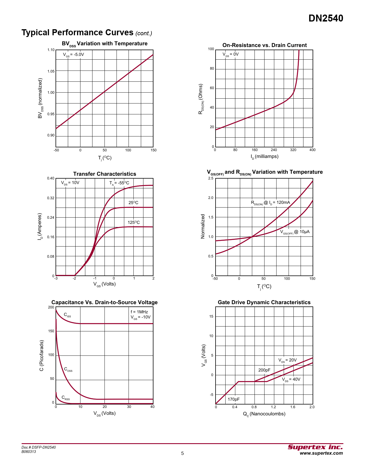

DN2540. Typical Performance Curves. BV Variation with Temperature. DSS. On-Resistance vs. Drain Current. Transfer Characteristics
DN2540 Typical Performance Curves
(cont.)
BV Variation with Temperature DSS On-Resistance vs. Drain Current
1.10 100 V = -5.0V V = 0V GS GS 80 1.05 ) 60 1.00 (Ohms (normalized 40 DSS R DS(ON) BV 0.95 20 0.90 0 -50 0 50 100 150 0 80 160 240 320 400 T (OC) I (milliamps) j D
Transfer Characteristics V and R Variation with Temperature GS(OFF) DS(ON)
0.40 2.5 V = 10V DS T = -55OC A 0.32 2.0 25OC R @ I = 120mA DS(ON) D 0.24 1.5 125OC (Amperes) V @ 10µA GS(OFF) I D 0.16 Normalized 1.0 0.08 0.5 0 0 -3 -2 -1 0 1 2 -50 0 50 100 150 V (Volts) GS T (OC) j
Capacitance Vs. Drain-to-Source Voltage Gate Drive Dynamic Characteristics
200 C f = 1MHz ISS V = -10V 15 GS 150 10 ) 100 5 (Volts) V = 20V V GS DS C (Picofarads COSS 200pF 0 50 V = 40V DS C -5 RSS 170pF 0 0 10 20 30 40 0 0.4 0.8 1.2 1.6 2.0 V (Volts) DS Q (Nanocoulombs) C Doc.# DSFP-DN2540
