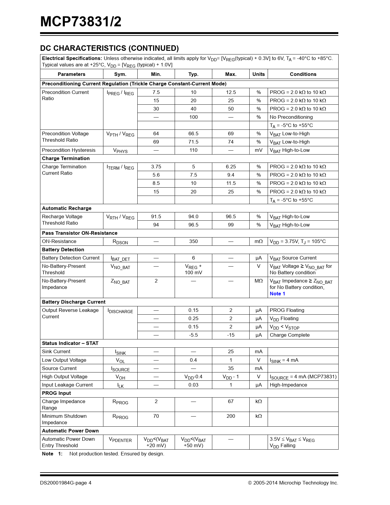

MCP73831/2. DC CHARACTERISTICS (CONTINUED). Electrical Specifications:. Parameters. Sym. Min. Typ. Max. Units. Conditions
MCP73831/2 DC CHARACTERISTICS (CONTINUED) Electrical Specifications: Parameters Sym Min Typ Max Units Conditions
link to page 3
Unless otherwise indicated, all limits apply for VDD= [VREG(typical) + 0.3V] to 6V, TA = -40°C to +85°C. Typical values are at +25°C, VDD = [VREG (typical) + 1.0V]
Parameters Sym. Min. Typ. Max. Units Conditions Preconditioning Current Regulation (Trickle Charge Constant-Current Mode)
Precondition Current IPREG / IREG 7.5 10 12.5 % PROG = 2.0 kto 10 k Ratio 15 20 25 % PROG = 2.0 kto 10 k 30 40 50 % PROG = 2.0 kto 10 k — 100 — % No Preconditioning TA = -5°C to +55°C Precondition Voltage VPTH / VREG 64 66.5 69 % VBAT Low-to-High Threshold Ratio 69 71.5 74 % VBAT Low-to-High Precondition Hysteresis VPHYS — 110 — mV VBAT High-to-Low
Charge Termination
Charge Termination ITERM / IREG 3.75 5 6.25 % PROG = 2.0 kto 10 k Current Ratio 5.6 7.5 9.4 % PROG = 2.0 kto 10 k 8.5 10 11.5 % PROG = 2.0 kto 10 k 15 20 25 % PROG = 2.0 kto 10 k TA = -5°C to +55°C
Automatic Recharge
Recharge Voltage VRTH / VREG 91.5 94.0 96.5 % VBAT High-to-Low Threshold Ratio 94 96.5 99 % VBAT High-to-Low
Pass Transistor ON-Resistance
ON-Resistance RDSON — 350 — m VDD = 3.75V, TJ = 105°C
Battery Detection
Battery Detection Current IBAT_DET — 6 — µA VBAT Source Current No-Battery-Present VNO_BAT — VREG + — V VBAT Voltage ≥ VNO_BAT for Threshold 100 mV No Battery condition No-Battery-Present ZNO_BAT 2 — — M VBAT Impedance ≥ ZNO_BAT Impedance for No Battery condition,
Note 1 Battery Discharge Current
Output Reverse Leakage IDISCHARGE — 0.15 2 µA PROG Floating Current — 0.25 2 µA VDD Floating — 0.15 2 µA VDD < VSTOP — -5.5 -15 µA Charge Complete
Status Indicator – STAT
Sink Current ISINK — — 25 mA Low Output Voltage VOL — 0.4 1 V ISINK = 4 mA Source Current ISOURCE — — 35 mA High Output Voltage VOH — VDD-0.4 VDD - 1 V ISOURCE = 4 mA (MCP73831) Input Leakage Current ILK — 0.03 1 µA High-Impedance
PROG Input
Charge Impedance RPROG 2 — 67 k Range Minimum Shutdown RPROG 70 — 200 k Impedance
Automatic Power Down
Automatic Power Down VPDENTER VDD<(VBAT VDD<(VBAT — 3.5V  VBAT  VREG Entry Threshold +20 mV) +50 mV) VDD Falling
