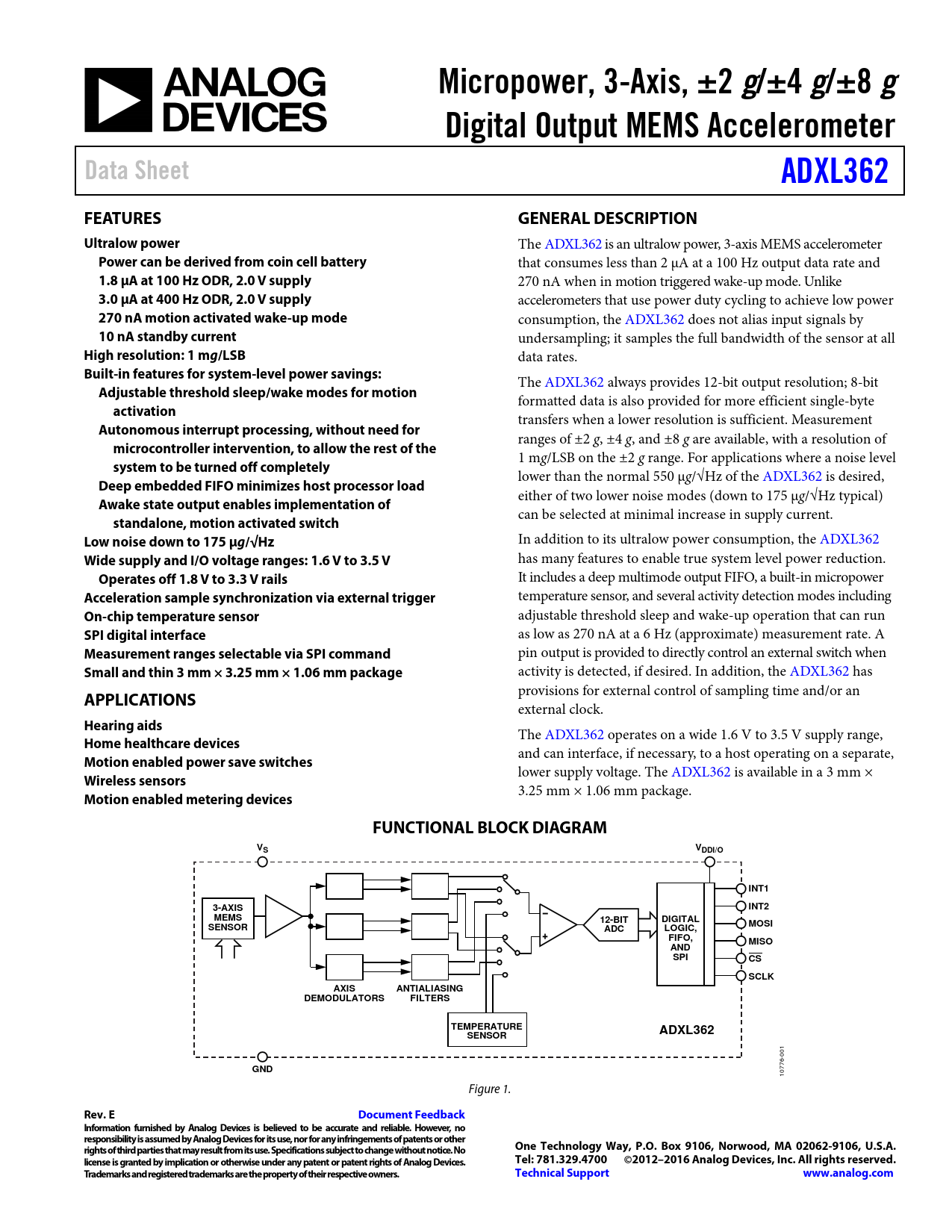

Micropower, 3-Axis, ±2 g. /±4 g. /±8 g. Digital Output MEMS Accelerometer. Data Sheet. ADXL362. FEATURES. GENERAL DESCRIPTION
Datasheet ADXL362 Analog Devices, Revision: F
Micropower, 3-Axis, ±2 g /±4 g /±8 g Digital Output MEMS Accelerometer Data Sheet ADXL362 FEATURES GENERAL DESCRIPTION Ultralow power
The ADXL362 is an ultralow power, 3-axis MEMS accelerometer
Power can be derived from coin cell battery
that consumes less than 2 µA at a 100 Hz output data rate and
1.8 µA at 100 Hz ODR, 2.0 V supply
270 nA when in motion triggered wake-up mode. Unlike
3.0 µA at 400 Hz ODR, 2.0 V supply
accelerometers that use power duty cycling to achieve low power
270 nA motion activated wake-up mode
consumption, the ADXL362 does not alias input signals by
10 nA standby current
undersampling; it samples the full bandwidth of the sensor at all
High resolution: 1 mg /LSB
data rates.
Built-in features for system-level power savings:
The ADXL362 always provides 12-bit output resolution; 8-bit
Adjustable threshold sleep/wake modes for motion
formatted data is also provided for more efficient single-byte
activation
transfers when a lower resolution is sufficient. Measurement
Autonomous interrupt processing, without need for
ranges of ±2 g, ±4 g, and ±8 g are available, with a resolution of
microcontroller intervention, to allow the rest of the
1 mg/LSB on the ±2 g range. For applications where a noise level
system to be turned off completely
lower than the normal 550 µg/√Hz of the ADXL362 is desired,
Deep embedded FIFO minimizes host processor load
either of two lower noise modes (down to 175 µg/√Hz typical)
Awake state output enables implementation of
can be selected at minimal increase in supply current.
standalone, motion activated switch Low noise down to 175 µg /√Hz
In addition to its ultralow power consumption, the ADXL362
Wide supply and I/O voltage ranges: 1.6 V to 3.5 V
has many features to enable true system level power reduction.
Operates off 1.8 V to 3.3 V rails
It includes a deep multimode output FIFO, a built-in micropower
Acceleration sample synchronization via external trigger
temperature sensor, and several activity detection modes including
On-chip temperature sensor
adjustable threshold sleep and wake-up operation that can run
SPI digital interface
as low as 270 nA at a 6 Hz (approximate) measurement rate. A
Measurement ranges selectable via SPI command
pin output is provided to directly control an external switch when
Small and thin 3 mm × 3.25 mm × 1.06 mm package
activity is detected, if desired. In addition, the ADXL362 has
APPLICATIONS
provisions for external control of sampling time and/or an external clock.
Hearing aids
The ADXL362 operates on a wide 1.6 V to 3.5 V supply range,
Home healthcare devices
and can interface, if necessary, to a host operating on a separate,
Motion enabled power save switches
lower supply voltage. The ADXL362 is available in a 3 mm ×
Wireless sensors
3.25 mm × 1.06 mm package.
Motion enabled metering devices FUNCTIONAL BLOCK DIAGRAM VS VDDI/O INT1 3-AXIS INT2 MEMS 12-BIT DIGITAL SENSOR MOSI ADC LOGIC, FIFO, MISO AND SPI CS SCLK AXIS ANTIALIASING DEMODULATORS FILTERS TEMPERATURE ADXL362 SENSOR
001
GND
10776- Figure 1.
