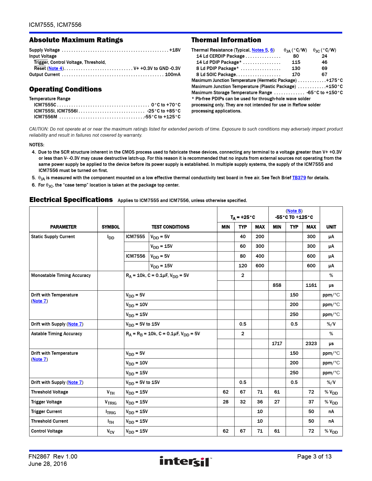

link. to. page. 4. link. to. page. 3. link. to. page. 3. link. to. page. 3. link. to. page. 4. link. to. page. 4. link. to. page. 4. link. to. page. 4. ICM7555,. ICM7556. Absolute. Maximum
link to page 4 link to page 3 link to page 3 link to page 3 link to page 4 link to page 4 link to page 4 link to page 4 ICM7555, ICM7556 Absolute Maximum
link to page 4 link to page 3 link to page 3 link to page 3 link to page 4 link to page 4 link to page 4 link to page 4 ICM7555, ICM7556 Absolute Maximum Ratings Thermal Information Supply Voltage . +18V Thermal Resistance (Typical, Notes 5, 6) JA (°C/W) JC (°C/W) Input Voltage 14 Ld CERDIP Package . 80 24 Trigger, Control Voltage, Threshold, 14 Ld PDIP Package* . 115 46 Reset (Note 4) . V+ +0.3V to GND -0.3V 8 Ld PDIP Package* . 130 69 Output Current . 100mA 8 Ld SOIC Package. 170 67 Maximum Junction Temperature (Hermetic Package) . .+175°C Operating Conditions Maximum Junction Temperature (Plastic Package) . .+150°C Maximum Storage Temperature Range . -65°C to +150°C Temperature Range * Pb-free PDIPs can be used for through-hole wave solder ICM7555C . 0°C to +70°C processing only. They are not intended for use in Reflow solder ICM7555I, ICM7556I . -25°C to +85°C processing applications. ICM7556M . .-55°C to +125°C CAUTION: Do not operate at or near the maximum ratings listed for extended periods of time. Exposure to such conditions may adversely impact product reliability and result in failures not covered by warranty. NOTES: 4. Due to the SCR structure inherent in the CMOS process used to fabricate these devices, connecting any terminal to a voltage greater than V+ +0.3V or less than V- -0.3V may cause destructive latch-up. For this reason it is recommended that no inputs from external sources not operating from the same power supply be applied to the device before its power supply is established. In multiple supply systems, the supply of the ICM7555 and ICM7556 must be turned on first. 5. JA is measured with the component mounted on a low effective thermal conductivity test board in free air. See Tech Brief TB379 for details. 6. For JC, the “case temp” location is taken at the package top center. Electrical Specifications Applies to ICM7555 and ICM7556, unless otherwise specified. (Note 8) TA = +25°C -55°C TO+125°C PARAMETER SYMBOL TEST CONDITIONS MIN TYP MAX MIN TYP MAX UNIT Static Supply Current IDD ICM7555 VDD = 5V 40 200 300 µA VDD = 15V 60 300 300 µA ICM7556 VDD = 5V 80 400 600 µA VDD = 15V 120 600 600 µA Monostable Timing Accuracy RA = 10k, C = 0.1µF, VDD = 5V 2 % 858 1161 µs Drift with Temperature VDD = 5V 150 ppm/°C (Note 7) VDD = 10V 200 ppm/°C VDD = 15V 250 ppm/°C Drift with Supply (Note 7) VDD = 5V to 15V 0.5 0.5 %/V Astable Timing Accuracy RA = RB = 10k, C = 0.1µF, VDD = 5V 2 % 1717 2323 µs Drift with Temperature VDD = 5V 150 ppm/°C (Note 7) VDD = 10V 200 ppm/°C VDD = 15V 250 ppm/°C Drift with Supply (Note 7) VDD = 5V to 15V 0.5 0.5 %/V Threshold Voltage VTH VDD = 15V 62 67 71 61 72 % VDD Trigger Voltage VTRIG VDD = 15V 28 32 36 27 37 % VDD Trigger Current ITRIG VDD = 15V 10 50 nA Threshold Current ITH VDD = 15V 10 50 nA Control Voltage VCV VDD = 15V 62 67 71 61 72 % VDD FN2867 Rev 1.00 Page 3 of 13 June 28, 2016
