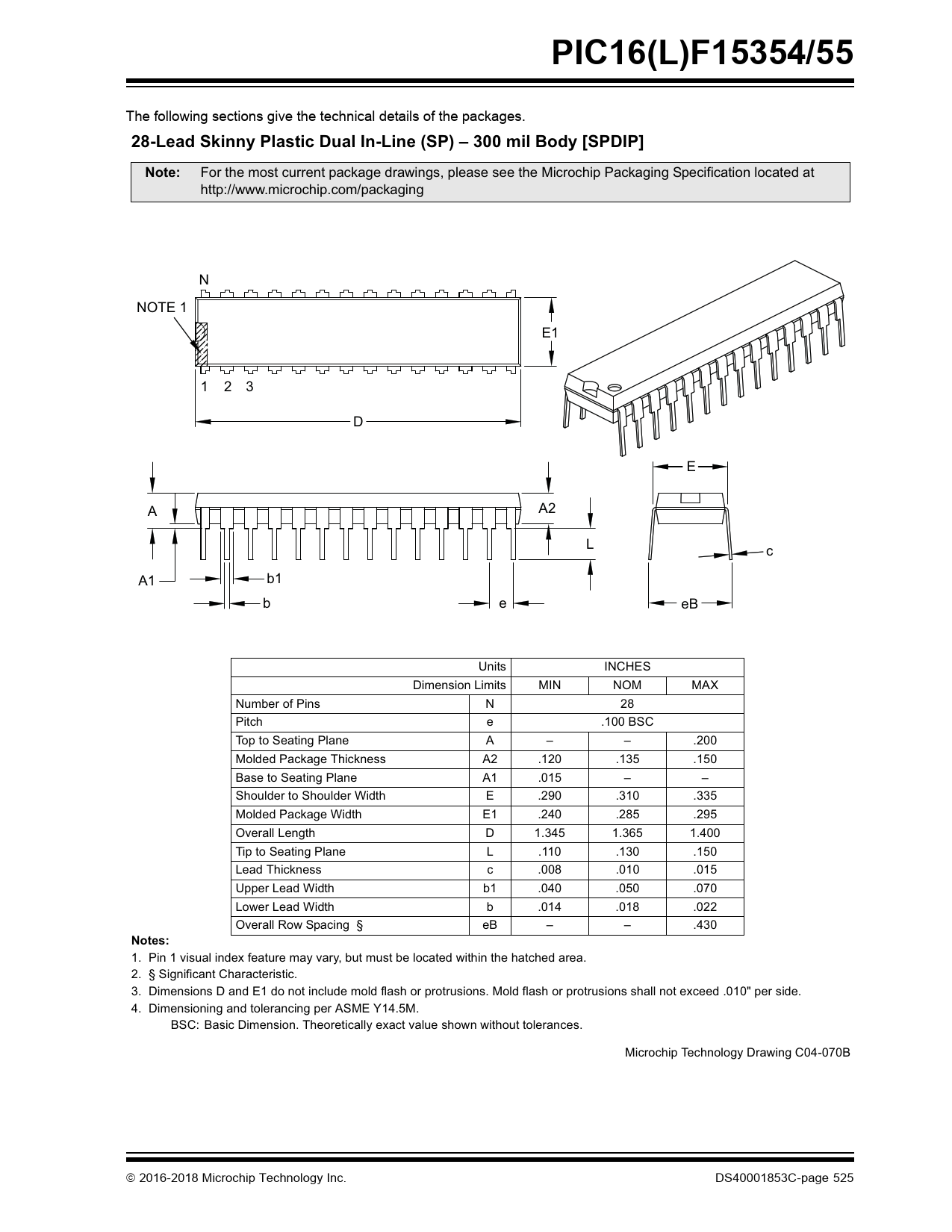

The following sections give the technical details of the packages.
J * +#* $ * K% 6#/ ##* ! K ' * *%* ** HVV666+ +V K N NOTE 1 E1 1 2 3 D E A A2 L c A1 b1 b e eB X*# Y9[? +#\+*# Y Y] ^ Y$+5 '!# Y _ !* G9 **! ` ` %%! K K## ; G#**! ` ` $% * $% j%* ? ; ;; %%! Kj%* ? _ ]" \* ; ;{ **! \ ; \% K## _ X \%j%* 5 \6 \%j%* 5 _ ]" 6 7 G ` ` ;
