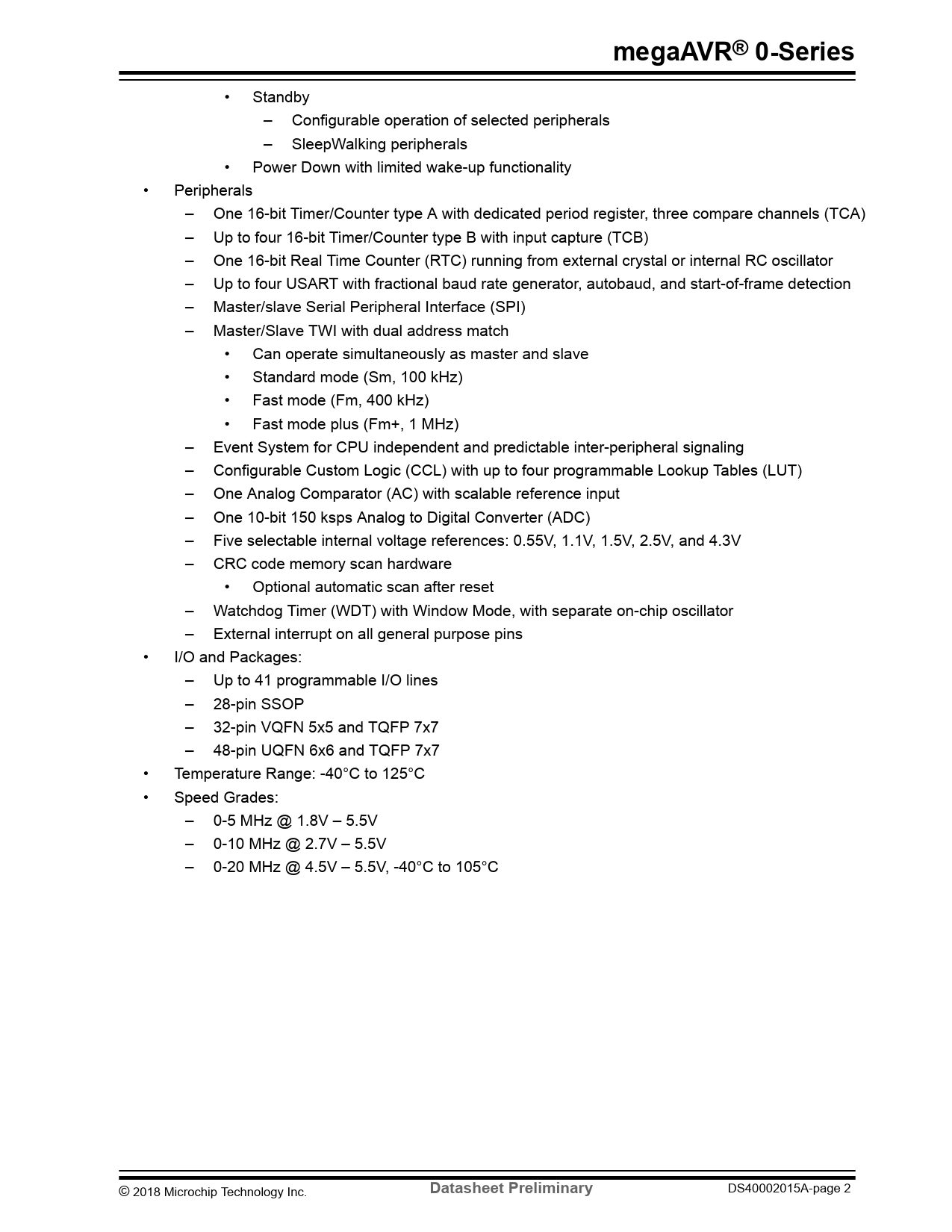

• Standby – Configurable operation of selected peripherals – SleepWalking peripherals • Power Down with limited wake-up functionality • Peripherals – One 16-bit Timer/Counter type A with dedicated period register, three compare channels (TCA) – Up to four 16-bit Timer/Counter type B with input capture (TCB) – One 16-bit Real Time Counter (RTC) running from external crystal or internal RC oscillator – Up to four USART with fractional baud rate generator, autobaud, and start-of-frame detection – Master/slave Serial Peripheral Interface (SPI) – Master/Slave TWI with dual address match • Can operate simultaneously as master and slave • Standard mode (Sm, 100 kHz) • Fast mode (Fm, 400 kHz) • Fast mode plus (Fm+, 1 MHz) – Event System for CPU independent and predictable inter-peripheral signaling – Configurable Custom Logic (CCL) with up to four programmable Lookup Tables (LUT) – One Analog Comparator (AC) with scalable reference input – One 10-bit 150 ksps Analog to Digital Converter (ADC) – Five selectable internal voltage references: 0.55V, 1.1V, 1.5V, 2.5V, and 4.3V – CRC code memory scan hardware • Optional automatic scan after reset – Watchdog Timer (WDT) with Window Mode, with separate on-chip oscillator – External interrupt on all general purpose pins • I/O and Packages: – Up to 41 programmable I/O lines – 28-pin SSOP – 32-pin VQFN 5x5 and TQFP 7x7 – 48-pin UQFN 6x6 and TQFP 7x7 • Temperature Range: -40°C to 125°C • Speed Grades: – 0-5 MHz @ 1.8V – 5.5V – 0-10 MHz @ 2.7V – 5.5V – 0-20 MHz @ 4.5V – 5.5V, -40°C to 105°C © 2018 Microchip Technology Inc.
