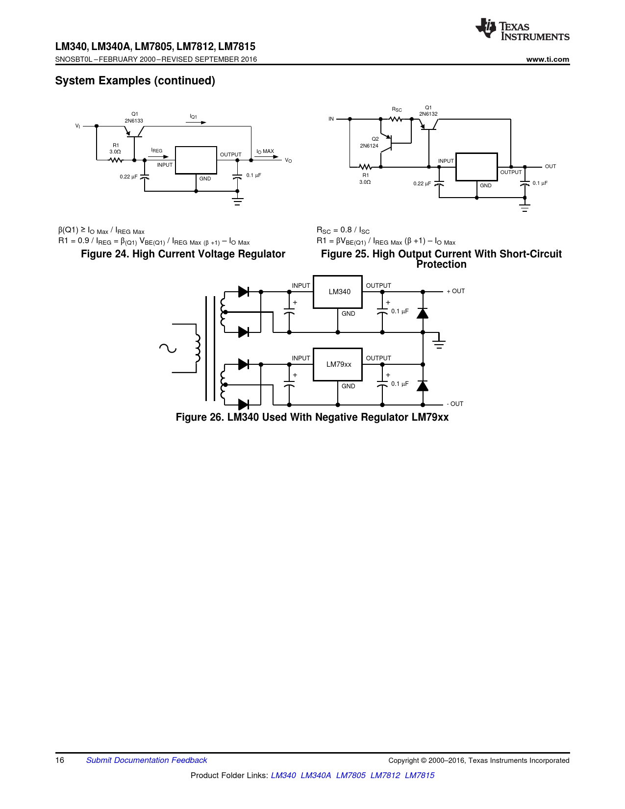

LM340,. LM340A. , LM7805,. LM7812. , LM7815. www.ti.com. System Examples (continued). Figure 24. High Current Voltage Regulator
LM340, LM340A , LM7805, LM7812 , LM7815 www.ti.com System Examples (continued) Figure 24 High Current Voltage Regulator
SNOSBT0L – FEBRUARY 2000 – REVISED SEPTEMBER 2016
Q1 RSC Q1 I 2N6132 Q1 2N6133 IN VI Q2 R1 2N6124 3.0: IREG IO MAX OUTPUT VO INPUT INPUT OUT OUTPUT 0.1 PF 0.22 PF R1 GND 3.0: 0.22 PF 0.1 PF GND β(Q1) ≥ IO Max / IREG Max RSC = 0.8 / ISC R1 = 0.9 / IREG = β(Q1) VBE(Q1) / IREG Max (β +1) – IO Max R1 = βVBE(Q1) / IREG Max (β +1) – IO Max
Figure 24. High Current Voltage Regulator Figure 25. High Output Current With Short-Circuit Protection
INPUT OUTPUT LM340 + OUT + + 0.1 PF GND INPUT OUTPUT LM79xx + + 0.1 PF GND - OUT
Figure 26. LM340 Used With Negative Regulator LM79xx
