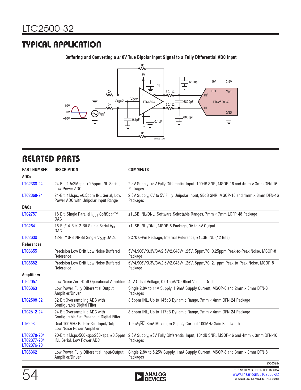

TYPICAL APPLICATION. Buffering and Converting a ±10V True Bipolar Input Signal to a Fully Differential ADC Input
TYPICAL APPLICATION Buffering and Converting a ±10V True Bipolar Input Signal to a Fully Differential ADC Input
LTC2500-32
1k 8V 6800pF 5V 2.5V 0.1µF 2k REF V + 30.1Ω DD IN+ VOCM VREF/2 LTC6363 6800pF LTC2500-32 2k 30.1Ω 10V – IN– 0V V + GND IN 6800pF –10V 0.1µF 0.1µF –3V 1k 250032 TA02
