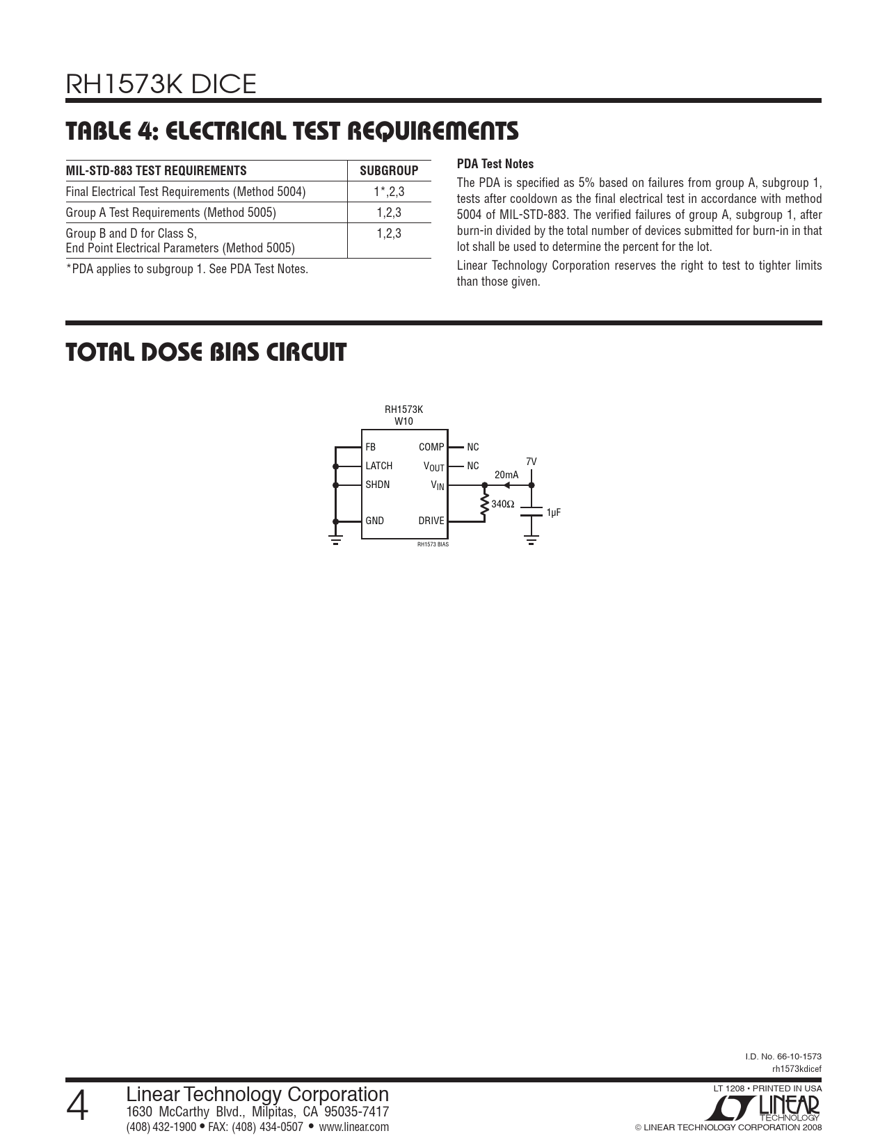

Pages / Page4 / 4 — TABLE 4: ELECTRICAL TEST REQUIREMENTS. PDA Test Notes. MIL-STD-883 TEST …
File Format / SizePDF / 69 Kb
TABLE 4: ELECTRICAL TEST REQUIREMENTS. PDA Test Notes. MIL-STD-883 TEST REQUIREMENTS. SUBGROUP. TOTAL DOSE BIAS CIRCUIT
TABLE 4: ELECTRICAL TEST REQUIREMENTS PDA Test Notes MIL-STD-883 TEST REQUIREMENTS SUBGROUP TOTAL DOSE BIAS CIRCUIT
RH1573K DICE
The PDA is specifi ed as 5% based on failures from group A, subgroup 1, Final Electrical Test Requirements (Method 5004) 1*,2,3 tests after cooldown as the fi nal electrical test in accordance with method Group A Test Requirements (Method 5005) 1,2,3 5004 of MIL-STD-883. The verifi ed failures of group A, subgroup 1, after Group B and D for Class S, 1,2,3 burn-in divided by the total number of devices submitted for burn-in in that End Point Electrical Parameters (Method 5005) lot shall be used to determine the percent for the lot. *PDA applies to subgroup 1. See PDA Test Notes. Linear Technology Corporation reserves the right to test to tighter limits than those given.
RH1573K W10 FB COMP NC LATCH V 7V OUT NC 20mA SHDN VIN 340Ω 1μF GND DRIVE RH1573 BIAS I.D. No. 66-10-1573 rh1573kdicef 4 Linear Technology Corporation LT 1208 • PRINTED IN USA 1630 McCarthy Blvd., Milpitas, CA 95035-7417 (408) 432-1900 ● FAX: (408) 434-0507 ● www.linear.com © LINEAR TECHNOLOGY CORPORATION 2008
