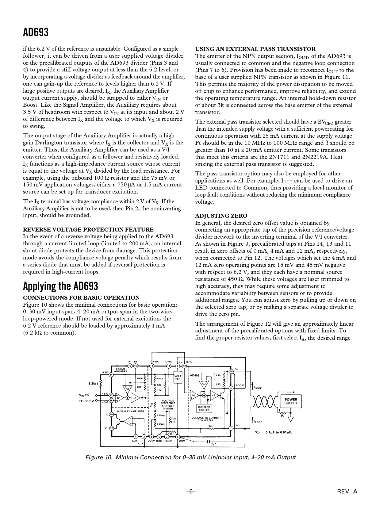

CONNECTIONS FOR BASIC OPERATION
additional ranges. You can adjust zero by pulling up or down on Figure 10 shows the minimal connections for basic operation: the selected zero tap, or by making a separate voltage divider to 0–30 mV input span, 4–20 mA output span in the two-wire, drive the zero pin. loop-powered mode. If not used for external excitation, the 6.2 V reference should be loaded by approximately 1 mA The arrangement of Figure 12 will give an approximately linear (6.2 kΩ to common). adjustment of the precalibrated options with fixed limits. To find the proper resistor values, first select IA, the desired range Figure 10. Minimal Connection for 0–30 mV Unipolar Input, 4–20 mA Output –6– REV. A
