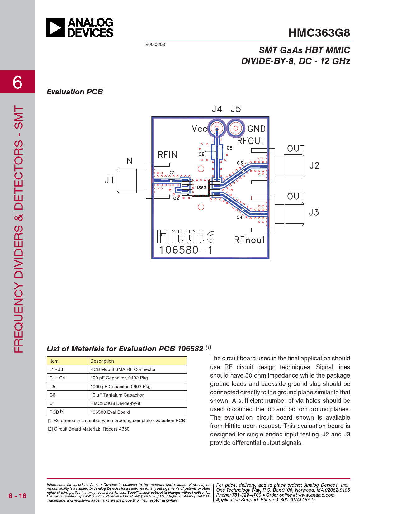

HMC363G8. SMT GaAs HBT MMIC. DIVIDE-BY-8, DC - 12 GHz. Evaluation PCB. List of Materials for Evaluation PCB 106582 [1]. 6 - 18
HMC363G8 SMT GaAs HBT MMIC DIVIDE-BY-8, DC - 12 GHz Evaluation PCB List of Materials for Evaluation PCB 106582 [1] 6 - 18
HMC363G8
v00.0203
6
Evaluation PCB
T S - SM R O T C E T E & D S R E ID IV Y D NC E U Q E R F
The circuit board used in the fi nal application should Item Description use RF circuit design techniques. Signal lines J1 - J3 PCB Mount SMA RF Connector should have 50 ohm impedance while the package C1 - C4 100 pF Capacitor, 0402 Pkg. ground leads and backside ground slug should be C5 1000 pF Capacitor, 0603 Pkg. connected directly to the ground plane similar to that C6 10 μF Tantalum Capacitor shown. A sufficient number of via holes should be U1 HMC363G8 Divide-by-8 used to connect the top and bottom ground planes. PCB [2] 106580 Eval Board The evaluation circuit board shown is available [1] Reference this number when ordering complete evaluation PCB from Hittite upon request. This evaluation board is [2] Circuit Board Material: Rogers 4350 designed for single ended input testing. J2 and J3 provide differential output signals. Information furnish F e o d r pri by An ce, de alog Devic leis vie s rby eli, a eve nd to pla d to be accur ce o ate an r d der relia s ble , pl . Ho ease co wever, no For price, delivery, and to place orders: Analog Devices, Inc., responsibility is assumed by Analog Devices for its use, nor for any infringements of patents or other ntact Hittite Microwave Corporation: One Technology Way, P.O. Box 9106, Norwood, MA 02062-9106 rights of third parties that may result from its use. Specifications subject to change without notice. No
