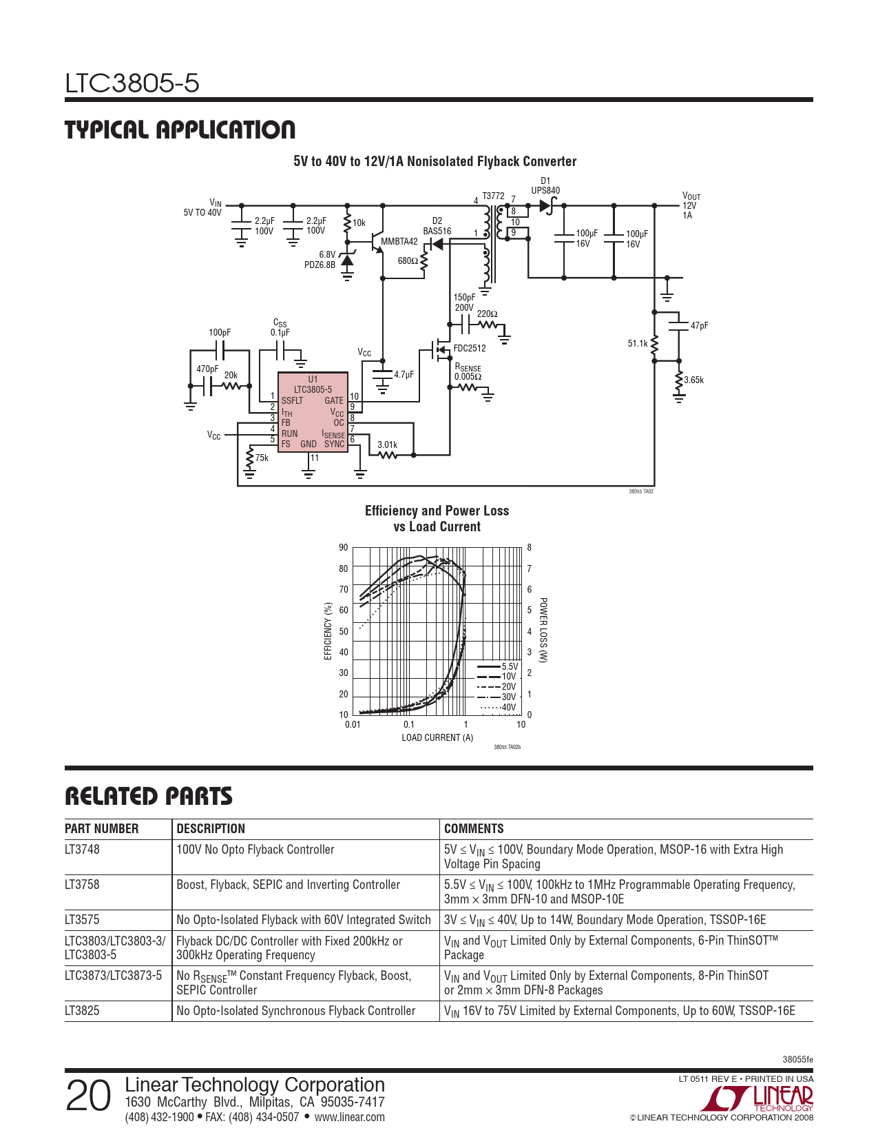

TYPICAL APPLICATION. 5V to 40V to 12V/1A Nonisolated Flyback Converter. Efficiency and Power Loss. vs Load Current
TYPICAL APPLICATION 5V to 40V to 12V/1A Nonisolated Flyback Converter Efficiency and Power Loss vs Load Current
LTC3805-5
D1 UPS840 T3772 V V 4 7 OUT IN 12V 5V TO 40V 8 2.2µF 1A 2.2µF 10k D2 10 100V 100V BAS516 1 9 100µF 100µF MMBTA42 16V 16V 6.8V PDZ6.8B 680Ω 150pF 200V 220Ω CSS 47pF 100pF 0.1µF 51.1k FDC2512 VCC R 470pF SENSE 20k 4.7µF U1 0.005Ω 3.65k LTC3805-5 1 10 SSFLT GATE 2 9 I V 3 TH CC 8 FB OC 4 7 VCC RUN I 5 SENSE 6 FS GND SYNC 3.01k 75k 11 38055 TA02
90 8 80 7 70 6 POWER LOSS (W) 60 5 50 4 EFFICIENCY (%) 40 3 5.5V 30 2 10V 20V 20 1 30V 40V 10 0 0.01 0.1 1 10 LOAD CURRENT (A) 38055 TA02b
