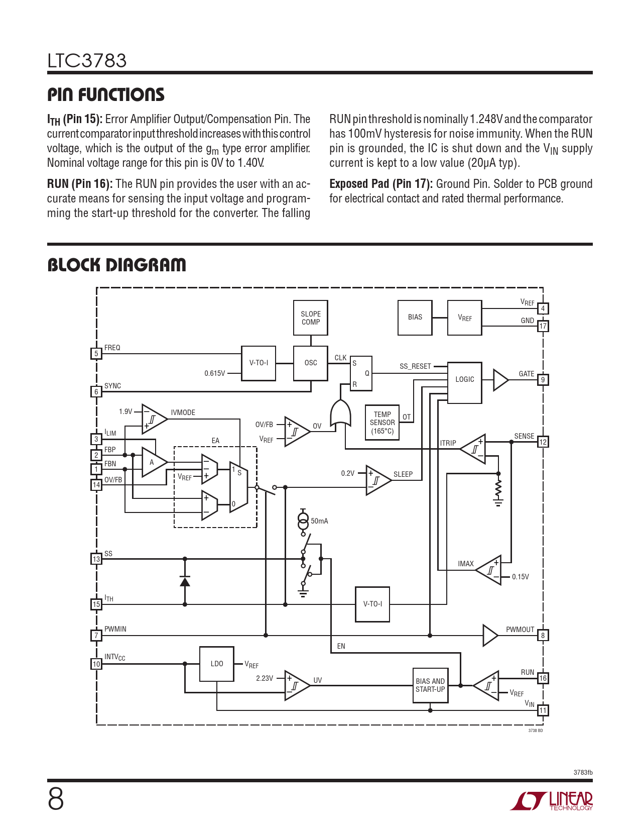

PIN FUNCTIONS ITH (Pin 15):
Error Amplifier Output/Compensation Pin. The RUN pin threshold is nominal y 1.248V and the comparator current comparator input threshold increases with this control has 100mV hysteresis for noise immunity. When the RUN voltage, which is the output of the gm type error amplifier. pin is grounded, the IC is shut down and the VIN supply Nominal voltage range for this pin is 0V to 1.40V. current is kept to a low value (20µA typ).
RUN (Pin 16):
The RUN pin provides the user with an ac-
Exposed Pad (Pin 17):
Ground Pin. Solder to PCB ground curate means for sensing the input voltage and program- for electrical contact and rated thermal performance. ming the start-up threshold for the converter. The falling
BLOCK DIAGRAM
