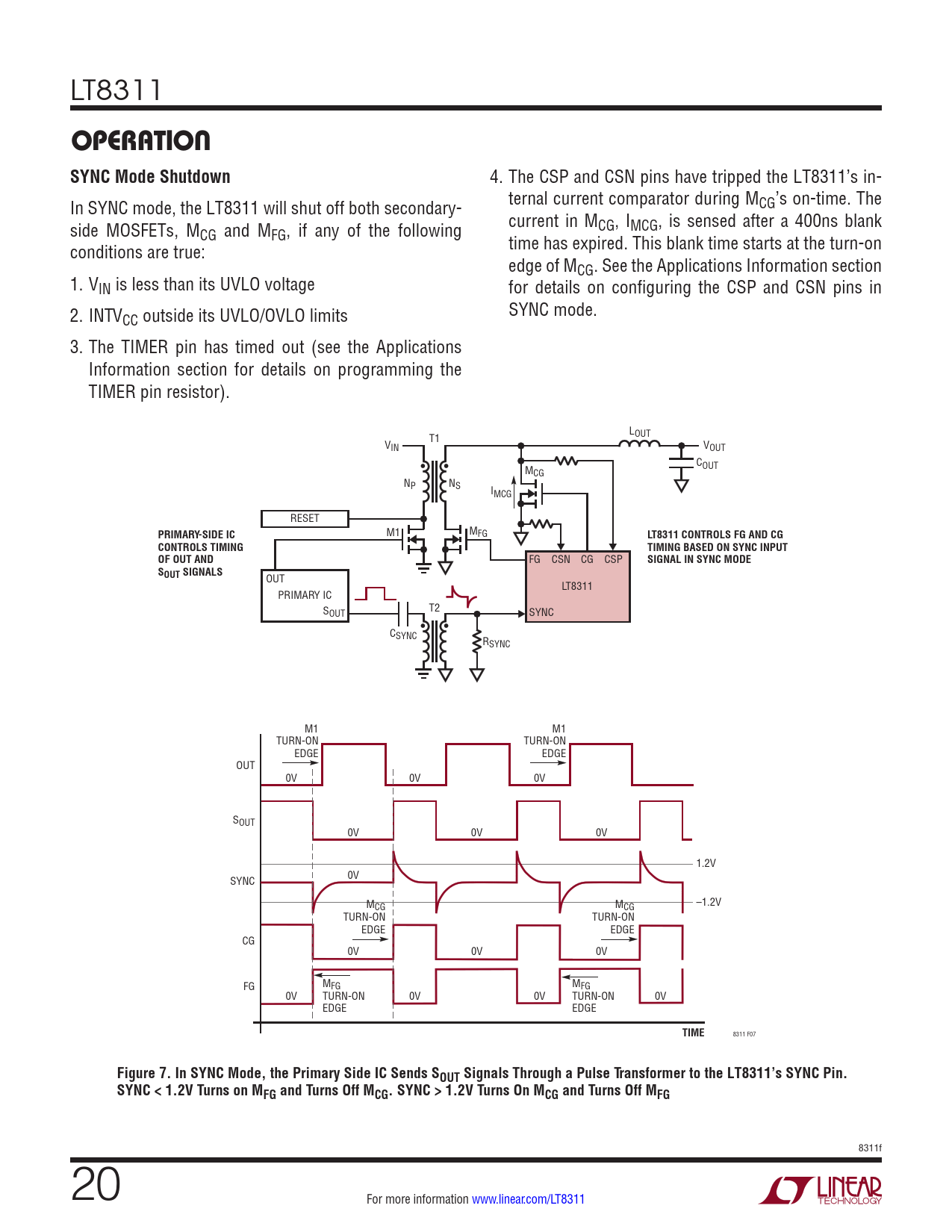

OPERATION SYNC Mode Shutdown
4. The CSP and CSN pins have tripped the LT8311’s in- In SYNC mode, the LT8311 will shut off both secondary- ternal current comparator during MCG’s on-time. The side MOSFETs, M current in MCG, IMCG, is sensed after a 400ns blank CG and MFG, if any of the following conditions are true: time has expired. This blank time starts at the turn-on edge of MCG. See the Applications Information section 1. VIN is less than its UVLO voltage for details on configuring the CSP and CSN pins in 2. INTV SYNC mode. CC outside its UVLO/OVLO limits 3. The TIMER pin has timed out (see the Applications Information section for details on programming the TIMER pin resistor). LOUT V T1 IN VOUT COUT • • MCG NP NS IMCG RESET

SIGNAL IN SYNC MODE SOUT SIGNALS
OUT LT8311 PRIMARY IC S T2 OUT SYNC • • CSYNC RSYNC M1 M1 TURN-ON TURN-ON EDGE EDGE OUT 0V 0V 0V SOUT 0V 0V 0V 1.2V 0V SYNC –1.2V MCG MCG TURN-ON TURN-ON EDGE EDGE CG 0V 0V 0V FG MFG MFG 0V TURN-ON 0V 0V TURN-ON 0V EDGE EDGE

Figure 7. In SYNC Mode, the Primary Side IC Sends SOUT Signals Through a Pulse Transformer to the LT8311’s SYNC Pin. SYNC < 1.2V Turns on MFG and Turns Off MCG. SYNC > 1.2V Turns On MCG and Turns Off MFG
