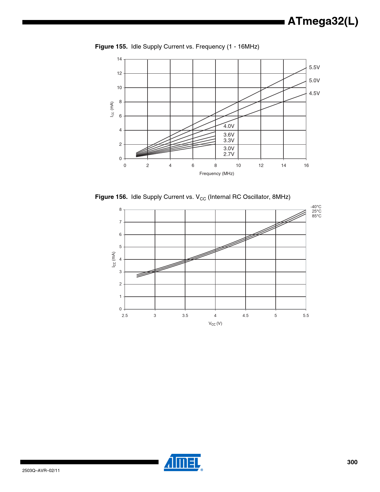

ATmega32(L) Figure 155.
Idle Supply Current vs. Frequency (1 - 16MHz) 14 5.5V 12 5.0V 10 4.5V 8 (mA) I CC 6 4.0V 4 3.6V 3.3V 2 3.0V 2.7V 0 0 2 4 6 8 10 12 14 16 Frequency (MHz)
Figure 156.
Idle Supply Current vs. V (Internal RC Oscillator, 8MHz) CC -40°C 8 25°C 85°C 7 6 5 4 (mA) I cc 3 2 1 0 2.5 3 3.5 4 4.5 5 5.5 Vcc (V)
