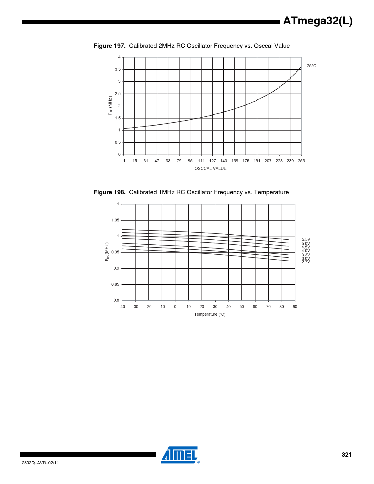

ATmega32(L) Figure 197.
Calibrated 2MHz RC Oscillator Frequency vs. Osccal Value 4 25°C 3.5 3 2.5 ) 2 (MHz F RC 1.5 1 0.5 0 -1 15 31 47 63 79 95 111 127 143 159 175 191 207 223 239 255 OSCCAL VALUE
Figure 198.
Calibrated 1MHz RC Oscillator Frequency vs. Temperature 1.1 1.05 1 5.5V ) 5.0V 4.5V 4.0V 0.95 (MHz 3.3V 3.0V F RC 2.7V 0.9 0.85 0.8 -40 -30 -20 -10 0 10 20 30 40 50 60 70 80 90 Temperature (°C)
