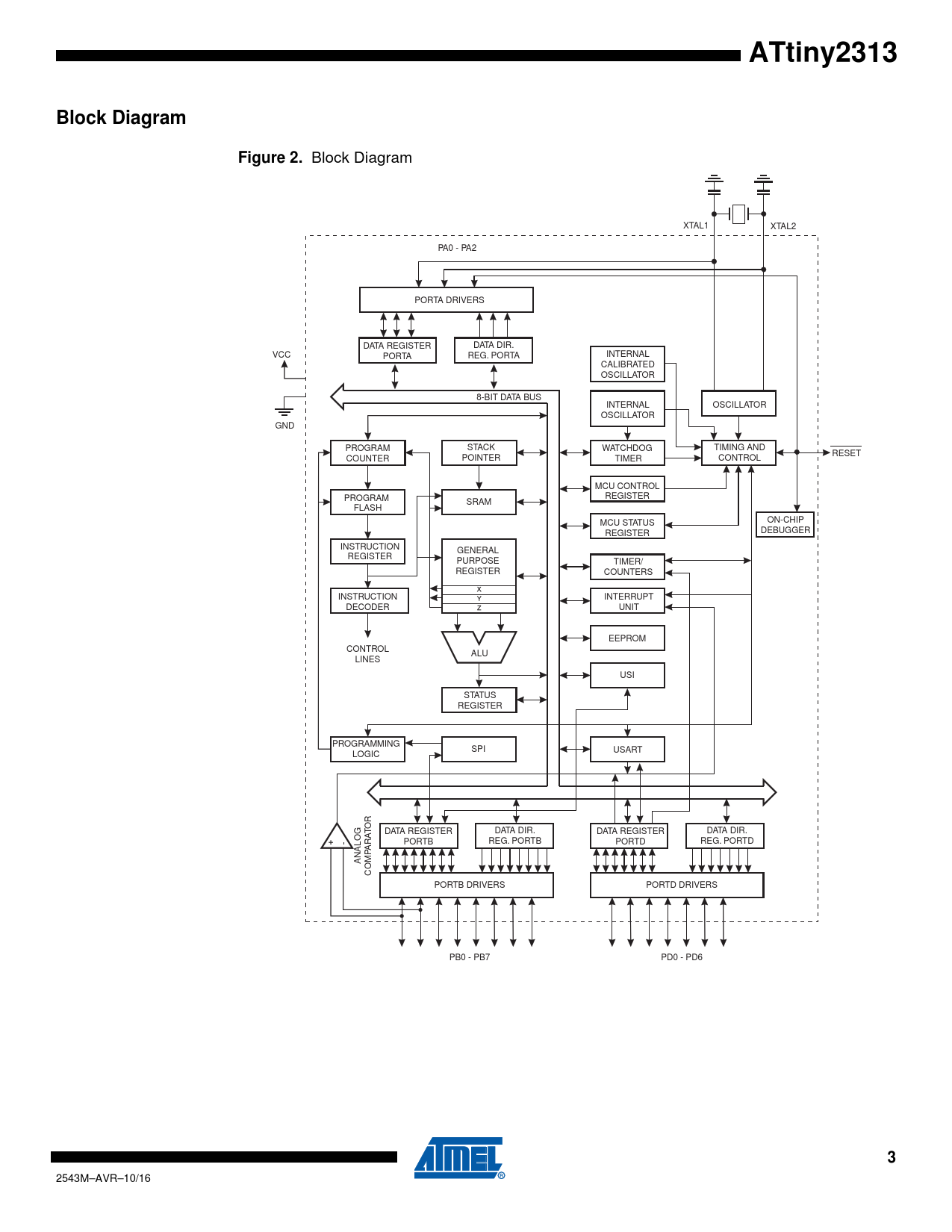

Pages / Page224 / 3 — ATtiny2313. Block Diagram. Figure 2
ATtiny2313 Block Diagram Figure 2
ATtiny2313 Block Diagram Figure 2.
Block Diagram XTAL1 XTAL2 PA0 - PA2 PORTA DRIVERS DATA REGISTER DATA DIR. VCC PORTA REG. PORTA INTERNAL CALIBRATED OSCILLATOR 8-BIT DATA BUS INTERNAL OSCILLATOR OSCILLATOR GND PROGRAM STACK WATCHDOG TIMING AND RESET COUNTER POINTER TIMER CONTROL MCU CONTROL PROGRAM REGISTER SRAM FLASH MCU STATUS ON-CHIP REGISTER DEBUGGER INSTRUCTION GENERAL REGISTER PURPOSE TIMER/ REGISTER COUNTERS INSTRUCTION INTERRUPT DECODER UNIT EEPROM CONTROL ALU LINES USI STATUS REGISTER PROGRAMMING SPI USART LOGIC R O T DATA REGISTER DATA DIR. DATA REGISTER DATA DIR. PORTB REG. PORTB PORTD REG. PORTD ARA ANALOG COMP PORTB DRIVERS PORTD DRIVERS PB0 - PB7 PD0 - PD6
