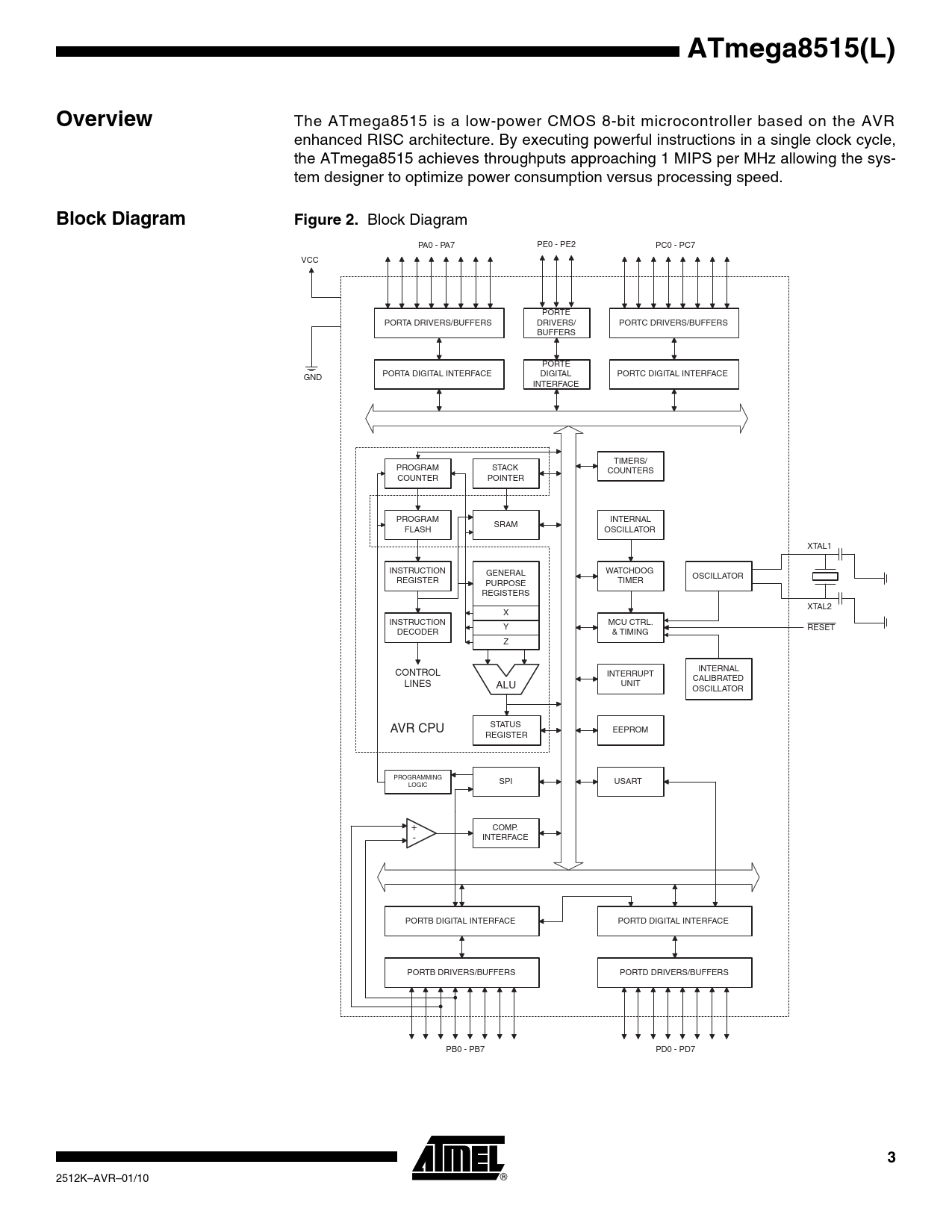

The ATmega8515 is a low-power CMOS 8-bit microcontroller based on the AVR enhanced RISC architecture. By executing powerful instructions in a single clock cycle, the ATmega8515 achieves throughputs approaching 1 MIPS per MHz allowing the sys- tem designer to optimize power consumption versus processing speed.
Block Diagram Figure 2.
Block Diagram PA0 - PA7 PE0 - PE2 PC0 - PC7 VCC PORTE PORTA DRIVERS/BUFFERS DRIVERS/ PORTC DRIVERS/BUFFERS BUFFERS PORTE PORTA DIGITAL INTERFACE DIGITAL PORTC DIGITAL INTERFACE GND INTERFACE TIMERS/ PROGRAM STACK COUNTERS COUNTER POINTER PROGRAM INTERNAL SRAM FLASH OSCILLATOR XTAL1 INSTRUCTION WATCHDOG GENERAL OSCILLATOR REGISTER TIMER PURPOSE REGISTERS XTAL2 X INSTRUCTION MCU CTRL. Y RESET DECODER & TIMING Z INTERNAL CONTROL INTERRUPT CALIBRATED LINES UNIT ALU OSCILLATOR STATUS AVR CPU EEPROM REGISTER PROGRAMMING SPI USART LOGIC + COMP. - INTERFACE PORTB DIGITAL INTERFACE PORTD DIGITAL INTERFACE PORTB DRIVERS/BUFFERS PORTD DRIVERS/BUFFERS PB0 - PB7 PD0 - PD7
