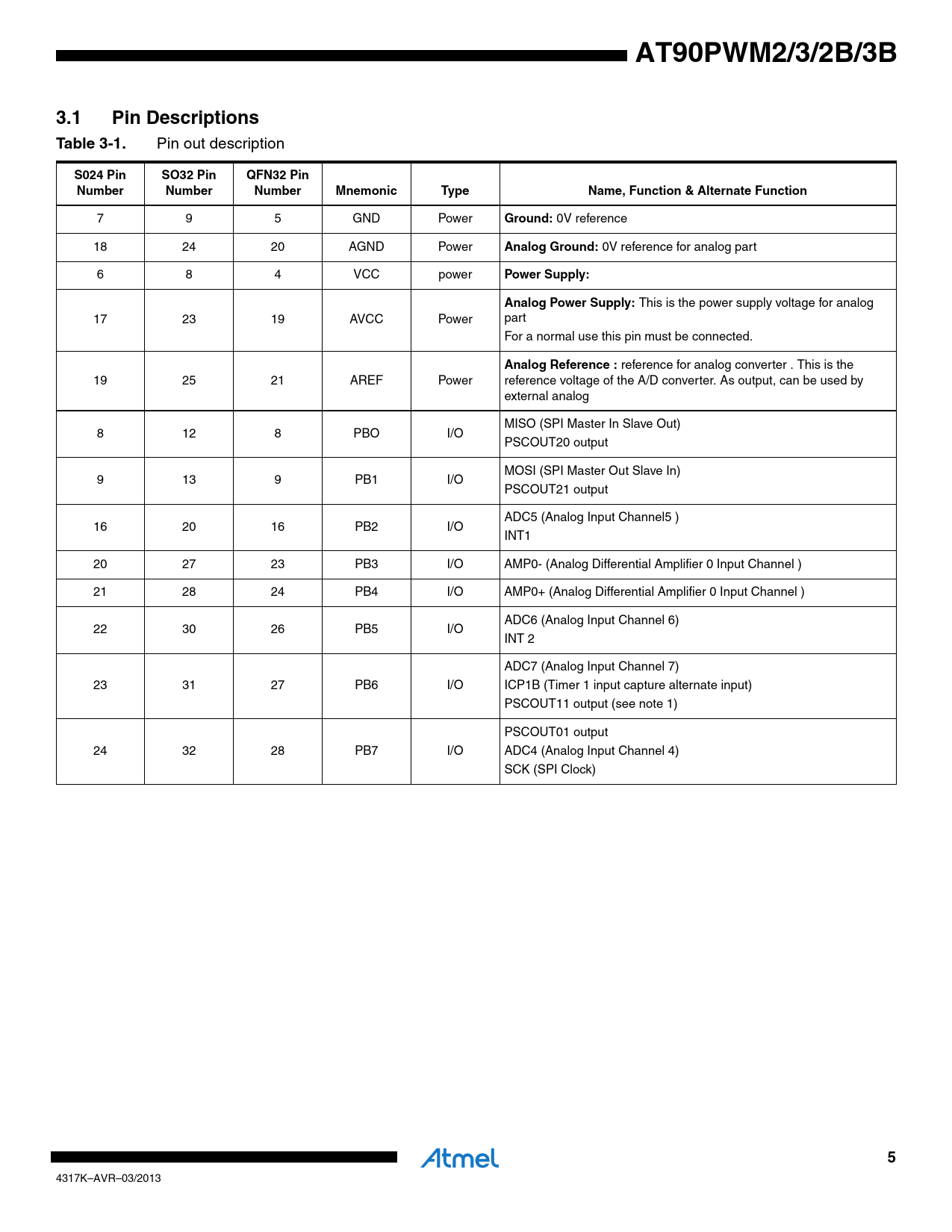

AT90PWM2/3/2B/3B. 3.1. Pin Descriptions. Table 3-1. S024 Pin. SO32 Pin. QFN32 Pin. Number. Mnemonic. Type
AT90PWM2/3/2B/3B 3.1 Pin Descriptions Table 3-1 S024 Pin SO32 Pin QFN32 Pin Number Mnemonic Type
AT90PWM2/3/2B/3B 3.1 Pin Descriptions Table 3-1.
Pin out description
S024 Pin SO32 Pin QFN32 Pin Number Number Number Mnemonic Type Name, Function & Alternate Function
7 9 5 GND Power
Ground:
0V reference 18 24 20 AGND Power
Analog Ground:
0V reference for analog part 6 8 4 VCC power
Power Supply: Analog Power Supply:
This is the power supply voltage for analog 17 23 19 AVCC Power part For a normal use this pin must be connected.
Analog Reference :
reference for analog converter . This is the 19 25 21 AREF Power reference voltage of the A/D converter. As output, can be used by external analog MISO (SPI Master In Slave Out) 8 12 8 PBO I/O PSCOUT20 output MOSI (SPI Master Out Slave In) 9 13 9 PB1 I/O PSCOUT21 output ADC5 (Analog Input Channel5 ) 16 20 16 PB2 I/O INT1 20 27 23 PB3 I/O AMP0- (Analog Differential Amplifier 0 Input Channel ) 21 28 24 PB4 I/O AMP0+ (Analog Differential Amplifier 0 Input Channel ) ADC6 (Analog Input Channel 6) 22 30 26 PB5 I/O INT 2 ADC7 (Analog Input Channel 7) 23 31 27 PB6 I/O ICP1B (Timer 1 input capture alternate input) PSCOUT11 output (see note 1) PSCOUT01 output 24 32 28 PB7 I/O ADC4 (Analog Input Channel 4) SCK (SPI Clock)
