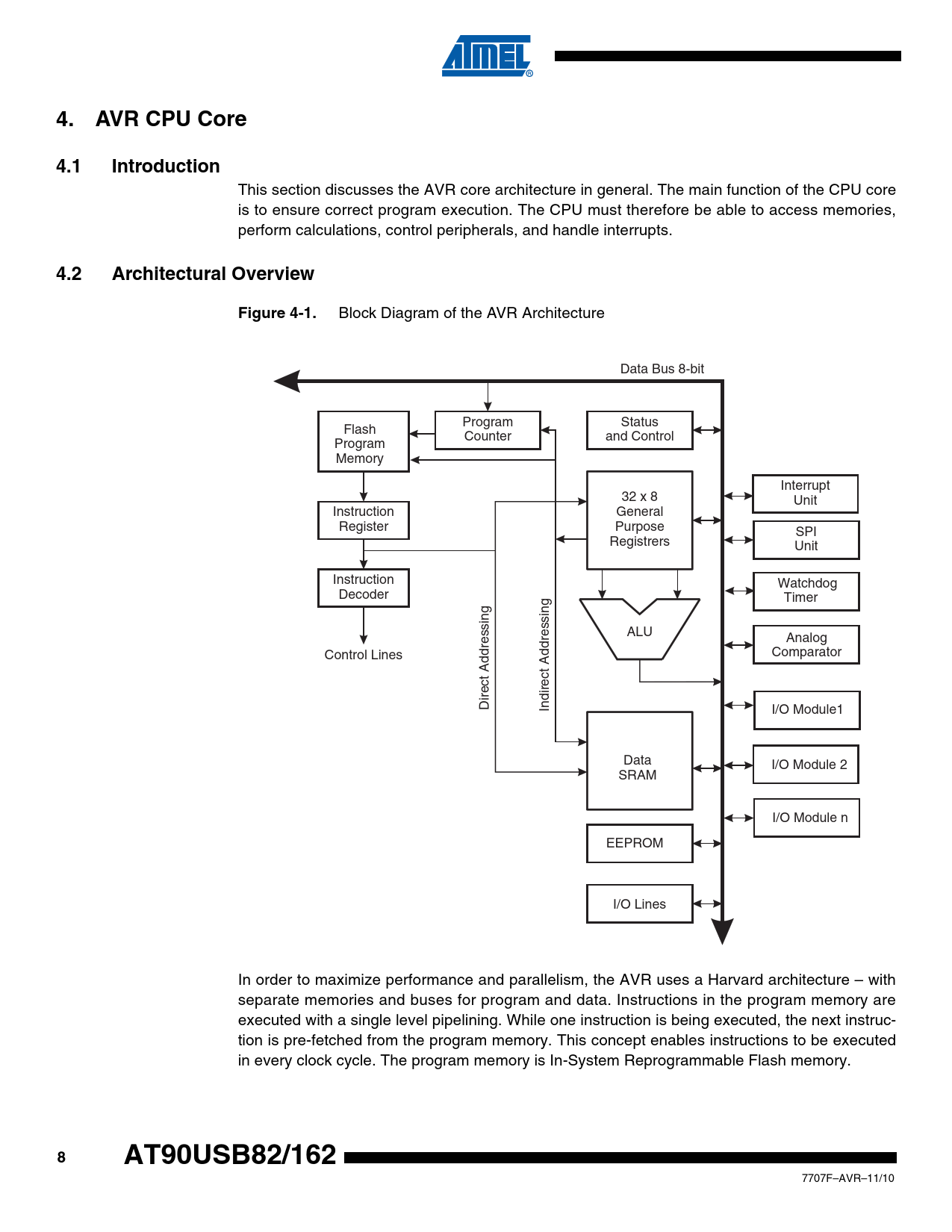

4. AVR CPU Core 4.1 Introduction
This section discusses the AVR core architecture in general. The main function of the CPU core is to ensure correct program execution. The CPU must therefore be able to access memories, perform calculations, control peripherals, and handle interrupts.
4.2 Architectural Overview Figure 4-1.
Block Diagram of the AVR Architecture Data Bus 8-bit Program Status Flash Counter and Control Program Memory Interrupt 32 x 8 Unit Instruction General Register Purpose SPI Registrers Unit Instruction Watchdog Decoder Timer ALU Analog Control Lines Comparator Direct Addressing Indirect Addressing I/O Module1 Data I/O Module 2 SRAM I/O Module n EEPROM I/O Lines In order to maximize performance and parallelism, the AVR uses a Harvard architecture – with separate memories and buses for program and data. Instructions in the program memory are executed with a single level pipelining. While one instruction is being executed, the next instruc- tion is pre-fetched from the program memory. This concept enables instructions to be executed in every clock cycle. The program memory is In-System Reprogrammable Flash memory.
