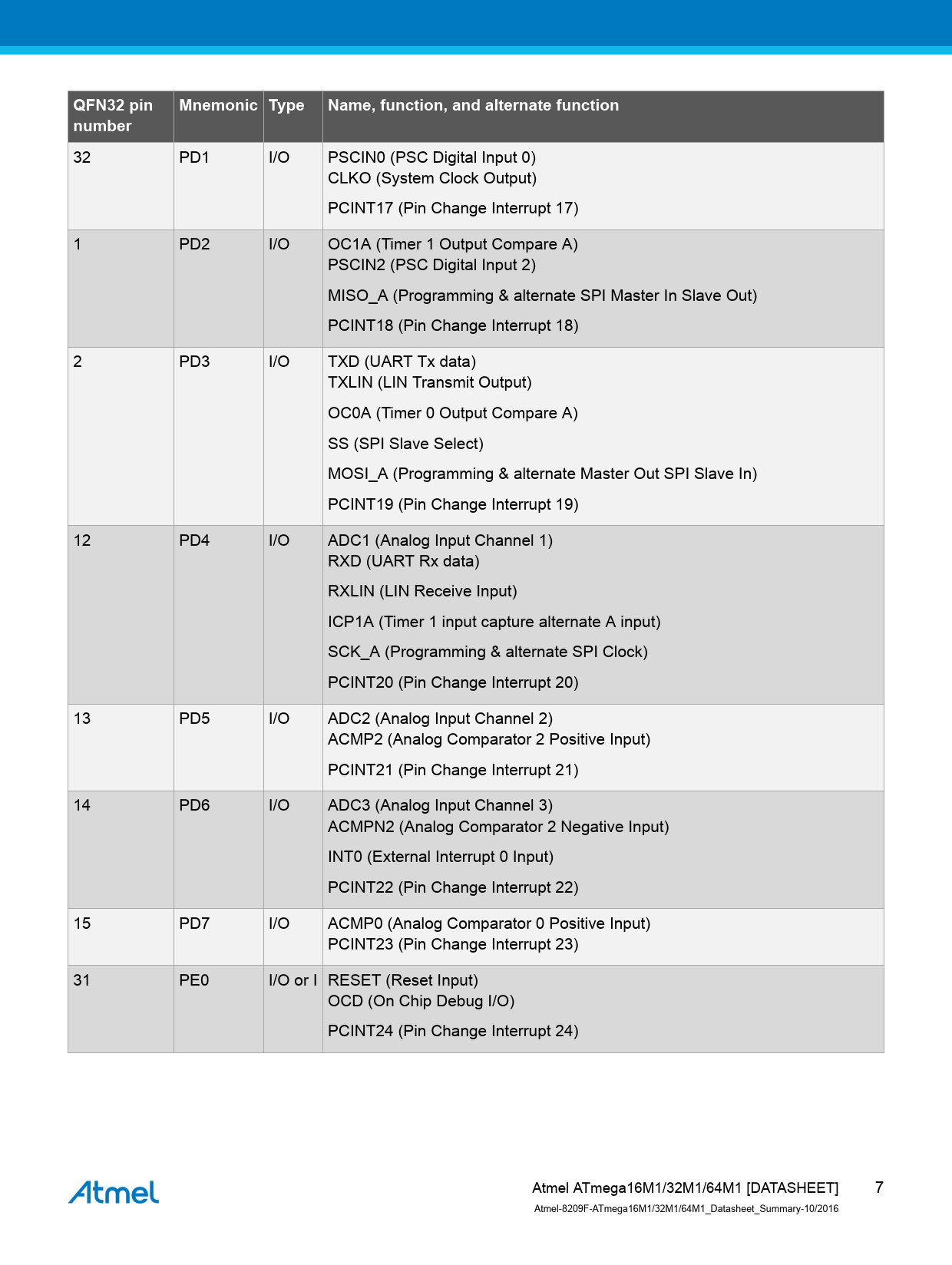

QFN32 pin. Mnemonic Type. Name, function, and alternate function. number
QFN32 pin Mnemonic Type Name, function, and alternate function number
32 PD1 I/O PSCIN0 (PSC Digital Input 0) CLKO (System Clock Output) PCINT17 (Pin Change Interrupt 17) 1 PD2 I/O OC1A (Timer 1 Output Compare A) PSCIN2 (PSC Digital Input 2) MISO_A (Programming & alternate SPI Master In Slave Out) PCINT18 (Pin Change Interrupt 18) 2 PD3 I/O TXD (UART Tx data) TXLIN (LIN Transmit Output) OC0A (Timer 0 Output Compare A) SS (SPI Slave Select) MOSI_A (Programming & alternate Master Out SPI Slave In) PCINT19 (Pin Change Interrupt 19) 12 PD4 I/O ADC1 (Analog Input Channel 1) RXD (UART Rx data) RXLIN (LIN Receive Input) ICP1A (Timer 1 input capture alternate A input) SCK_A (Programming & alternate SPI Clock) PCINT20 (Pin Change Interrupt 20) 13 PD5 I/O ADC2 (Analog Input Channel 2) ACMP2 (Analog Comparator 2 Positive Input) PCINT21 (Pin Change Interrupt 21) 14 PD6 I/O ADC3 (Analog Input Channel 3) ACMPN2 (Analog Comparator 2 Negative Input) INT0 (External Interrupt 0 Input) PCINT22 (Pin Change Interrupt 22) 15 PD7 I/O ACMP0 (Analog Comparator 0 Positive Input) PCINT23 (Pin Change Interrupt 23) 31 PE0 I/O or I RESET (Reset Input) OCD (On Chip Debug I/O) PCINT24 (Pin Change Interrupt 24) Atmel ATmega16M1/32M1/64M1 [DATASHEET] 7 Atmel-8209F-ATmega16M1/32M1/64M1_Datasheet_Summary-10/2016 Document Outline Introduction Features Table of Contents 1. Pin configurations 1.1. Pin descriptions 2. Ordering Information 2.1. ATmega16M1 2.2. ATmega32M1 2.3. ATmega64M1 3. Overview 3.1. Block diagram 3.2. Pin descriptions 3.2.1. VCC 3.2.2. GND 3.2.3. Port B (PB7..PB0) 3.2.4. Port C (PC7..PC0) 3.2.5. Port D (PD7..PD0) 3.2.6. Port E (PE2..0) RESET/ XTAL1/XTAL2 3.2.7. AVCC 3.2.8. AREF 4. Resources 5. About code examples 6. Data retention 7. Packaging Information 7.1. 32-pin 32A 7.2. PV 32 QFN
