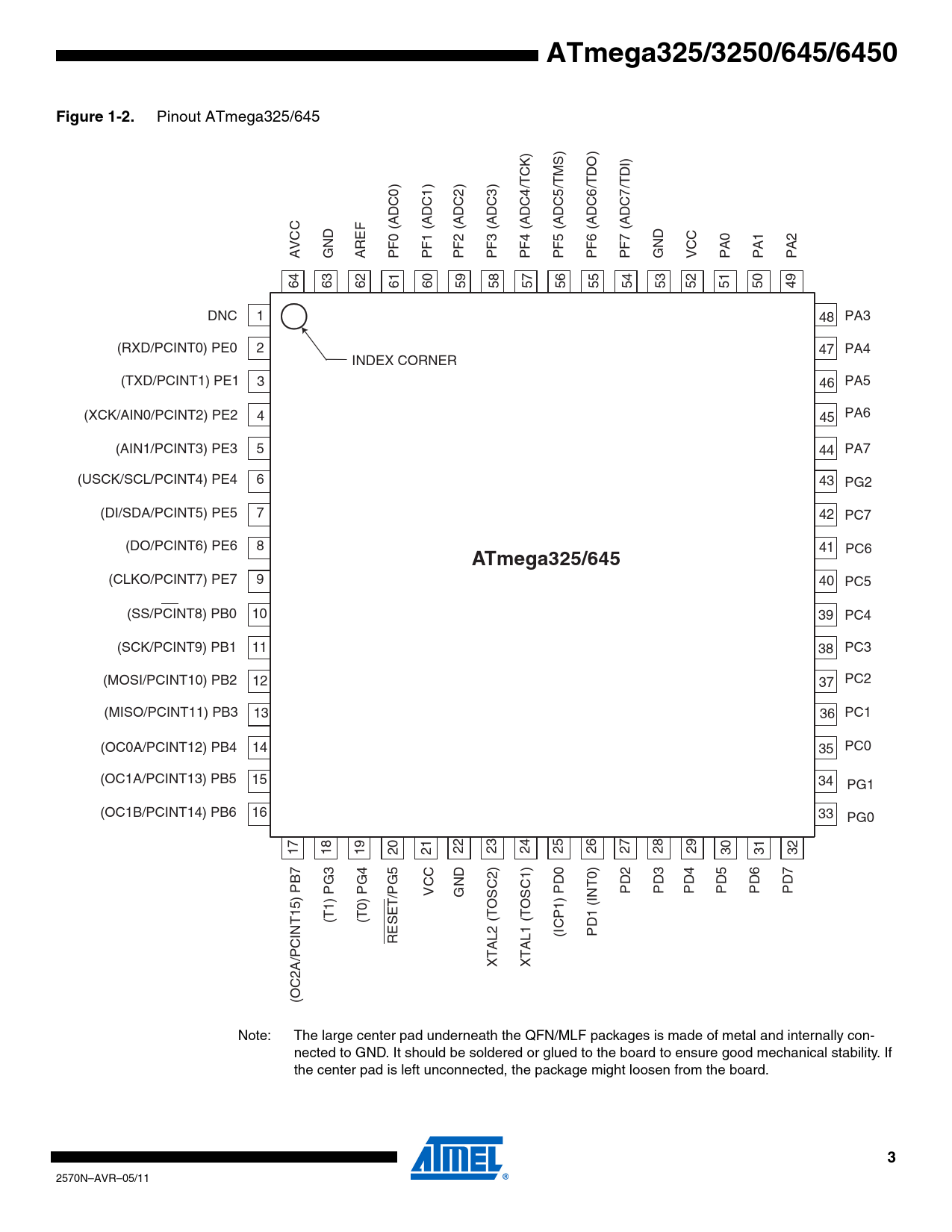

Pages / Page362 / 3 — ATmega325/3250/645/6450. Figure 1-2. ATmega325/645
File Format / SizePDF / 6.3 Mb
ATmega325/3250/645/6450 Figure 1-2 ATmega325/645
ATmega325/3250/645/6450 Figure 1-2.
Pinout ATmega325/645 CC D D V N N CC A G AREF PF0 (ADC0) PF1 (ADC1) PF2 (ADC2) PF3 (ADC3) PF4 (ADC4/TCK) PF5 (ADC5/TMS) PF6 (ADC6/TDO) PF7 (ADC7/TDI) G V PA0 PA1 PA2 64 63 62 61 60 59 58 57 56 55 54 53 52 51 50 49 DNC 1 48 PA3 (RXD/PCINT0) PE0 2 47 PA4 INDEX CORNER (TXD/PCINT1) PE1 3 46 PA5 (XCK/AIN0/PCINT2) PE2 PA6 4 45 (AIN1/PCINT3) PE3 5 44 PA7 (USCK/SCL/PCINT4) PE4 6 43 PG2 (DI/SDA/PCINT5) PE5 7 42 PC7 (DO/PCINT6) PE6 8 41 PC6
ATmega325/645
(CLKO/PCINT7) PE7 9 40 PC5 (SS/PCINT8) PB0 10 39 PC4 (SCK/PCINT9) PB1 11 38 PC3 (MOSI/PCINT10) PB2 12 PC2 37 (MISO/PCINT11) PB3 13 36 PC1 (OC0A/PCINT12) PB4 14 PC0 35 (OC1A/PCINT13) PB5 15 34 PG1 (OC1B/PCINT14) PB6 16 33 PG0 17 18 19 20 21 22 23 24 25 26 27 28 29 30 31 32 D CC N T0) V PD2 PD3 PD4 PD5 PD6 PD7 G N T15) PB7 (T1) PG3 (T0) PG4 N (ICP1) PD0 PD1 (I RESET/PG5 XTAL2 (TOSC2) XTAL1 (TOSC1) (OC2A/PCI Note: The large center pad underneath the QFN/MLF packages is made of metal and internally con- nected to GND. It should be soldered or glued to the board to ensure good mechanical stability. If the center pad is left unconnected, the package might loosen from the board.
