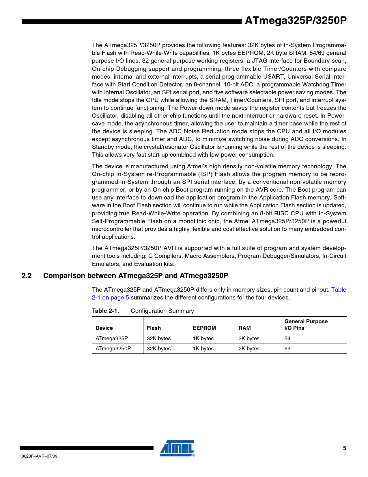

ATmega325P/3250P. 2.2. Comparison between ATmega325P and ATmega3250P. Table 2-1. General Purpose. Device. Flash. EEPROM. RAM. I/O Pins
ATmega325P/3250P 2.2 Comparison between ATmega325P and ATmega3250P Table 2-1 General Purpose Device Flash EEPROM RAM I/O Pins
ATmega325P/3250P
The ATmega325P/3250P provides the following features: 32K bytes of In-System Programma- ble Flash with Read-While-Write capabilities, 1K bytes EEPROM, 2K byte SRAM, 54/69 general purpose I/O lines, 32 general purpose working registers, a JTAG interface for Boundary-scan, On-chip Debugging support and programming, three flexible Timer/Counters with compare modes, internal and external interrupts, a serial programmable USART, Universal Serial Inter- face with Start Condition Detector, an 8-channel, 10-bit ADC, a programmable Watchdog Timer with internal Oscillator, an SPI serial port, and five software selectable power saving modes. The Idle mode stops the CPU while allowing the SRAM, Timer/Counters, SPI port, and interrupt sys- tem to continue functioning. The Power-down mode saves the register contents but freezes the Oscillator, disabling all other chip functions until the next interrupt or hardware reset. In Power- save mode, the asynchronous timer, allowing the user to maintain a timer base while the rest of the device is sleeping. The ADC Noise Reduction mode stops the CPU and all I/O modules except asynchronous timer and ADC, to minimize switching noise during ADC conversions. In Standby mode, the crystal/resonator Oscillator is running while the rest of the device is sleeping. This allows very fast start-up combined with low-power consumption. The device is manufactured using Atmel’s high density non-volatile memory technology. The On-chip In-System re-Programmable (ISP) Flash allows the program memory to be repro- grammed In-System through an SPI serial interface, by a conventional non-volatile memory programmer, or by an On-chip Boot program running on the AVR core. The Boot program can use any interface to download the application program in the Application Flash memory. Soft- ware in the Boot Flash section will continue to run while the Application Flash section is updated, providing true Read-While-Write operation. By combining an 8-bit RISC CPU with In-System Self-Programmable Flash on a monolithic chip, the Atmel ATmega325P/3250P is a powerful microcontroller that provides a highly flexible and cost effective solution to many embedded con- trol applications. The ATmega325P/3250P AVR is supported with a full suite of program and system develop- ment tools including: C Compilers, Macro Assemblers, Program Debugger/Simulators, In-Circuit Emulators, and Evaluation kits.
The ATmega325P and ATmega3250P differs only in memory sizes, pin count and pinout. Table 2-1 on page 5 summarizes the different configurations for the four devices.
Table 2-1.
Configuration Summary
ATmega325P 32K bytes 1K bytes 2K bytes 54 ATmega3250P 32K bytes 1K bytes 2K bytes 69
5
