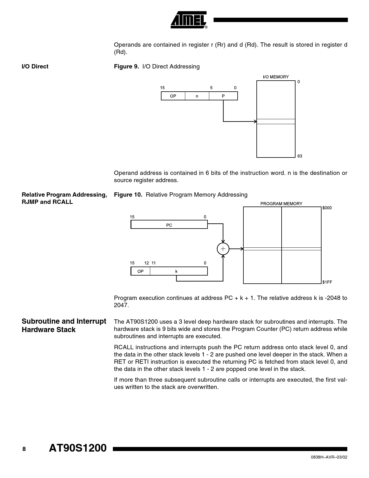

Operands are contained in register r (Rr) and d (Rd). The result is stored in register d (Rd).
I/O Direct Figure 9.
I/O Direct Addressing Operand address is contained in 6 bits of the instruction word. n is the destination or source register address.
Relative Program Addressing, Figure 10.
Relative Program Memory Addressing
RJMP and RCALL
Program execution continues at address PC + k + 1. The relative address k is -2048 to 2047.
Subroutine and Interrupt
The AT90S1200 uses a 3 level deep hardware stack for subroutines and interrupts. The
Hardware Stack
hardware stack is 9 bits wide and stores the Program Counter (PC) return address while subroutines and interrupts are executed. RCALL instructions and interrupts push the PC return address onto stack level 0, and the data in the other stack levels 1 - 2 are pushed one level deeper in the stack. When a RET or RETI instruction is executed the returning PC is fetched from stack level 0, and the data in the other stack levels 1 - 2 are popped one level in the stack. If more than three subsequent subroutine calls or interrupts are executed, the first val- ues written to the stack are overwritten.
