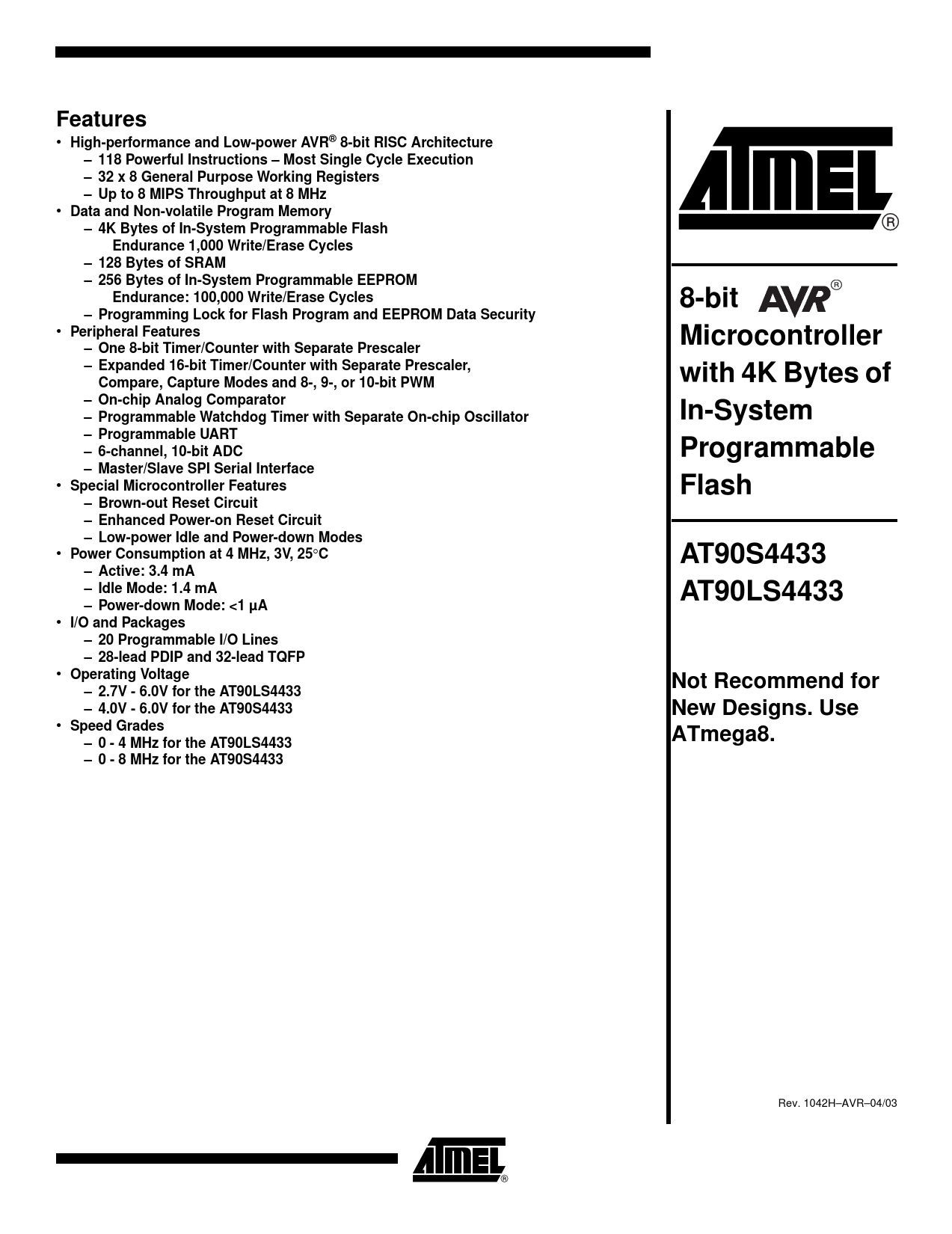

Features
High-performance and Low-power AVR® 8-bit RISC Architecture – 118 Powerful Instructions – Most Single Cycle Execution – 32 x 8 General Purpose Working Registers – Up to 8 MIPS Throughput at 8 MHz
Data and Non-volatile Program Memory – 4K Bytes of In-System Programmable Flash Endurance 1,000 Write/Erase Cycles – 128 Bytes of SRAM – 256 Bytes of In-System Programmable EEPROM Endurance: 100,000 Write/Erase Cycles 8-bit – Programming Lock for Flash Program and EEPROM Data Security
Peripheral Features Microcontroller – One 8-bit Timer/Counter with Separate Prescaler – Expanded 16-bit Timer/Counter with Separate Prescaler, with 4K Bytes of Compare, Capture Modes and 8-, 9-, or 10-bit PWM – On-chip Analog Comparator – Programmable Watchdog Timer with Separate On-chip Oscillator In-System – Programmable UART – 6-channel, 10-bit ADC Programmable – Master/Slave SPI Serial Interface
Special Microcontroller Features Flash – Brown-out Reset Circuit – Enhanced Power-on Reset Circuit – Low-power Idle and Power-down Modes
Power Consumption at 4 MHz, 3V, 25
C AT90S4433 – Active: 3.4 mA – Idle Mode: 1.4 mA AT90LS4433 – Power-down Mode: <1 µA
I/O and Packages – 20 Programmable I/O Lines – 28-lead PDIP and 32-lead TQFP
Operating Voltage Not Recommend for – 2.7V - 6.0V for the AT90LS4433 – 4.0V - 6.0V for the AT90S4433 New Designs. Use
Speed Grades ATmega8. – 0 - 4 MHz for the AT90LS4433 – 0 - 8 MHz for the AT90S4433
