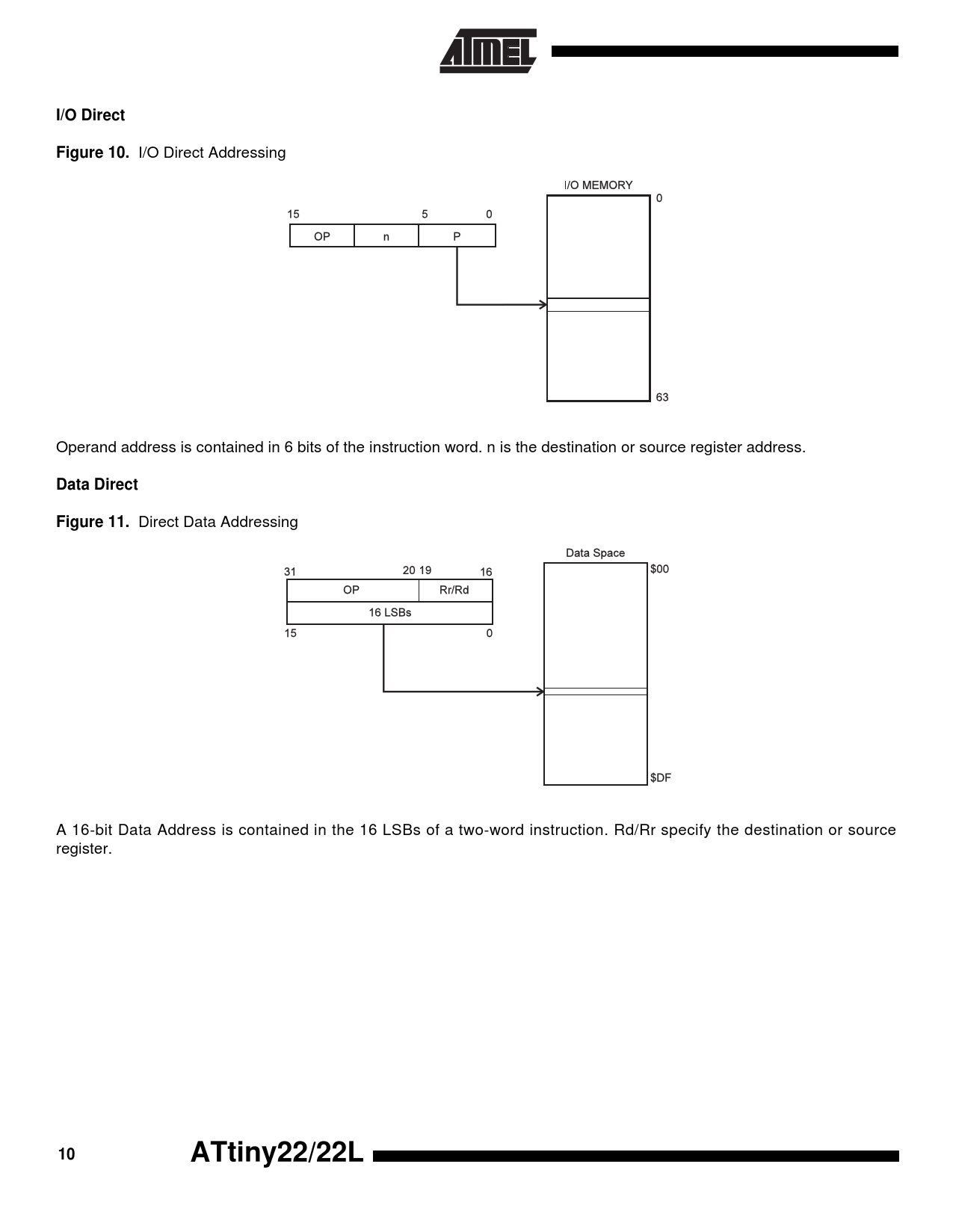

I/O Direct Figure 10.
I/O Direct Addressing Operand address is contained in 6 bits of the instruction word. n is the destination or source register address.
Data Direct Figure 11.
Direct Data Addressing A 16-bit Data Address is contained in the 16 LSBs of a two-word instruction. Rd/Rr specify the destination or source register.
