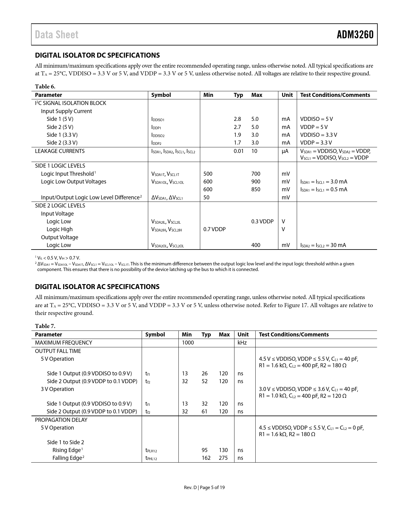

Data Sheet. ADM3260. DIGITAL ISOLATOR DC SPECIFICATIONS. Table 6. Parameter. Symbol. Min. Typ. Max. Unit Test Conditions/Comments
Data Sheet ADM3260 DIGITAL ISOLATOR DC SPECIFICATIONS Table 6 Parameter Symbol Min Typ Max Unit Test Conditions/Comments
link to page 14 link to page 6 link to page 6
All minimum/maximum specifications apply over the entire recommended operating range, unless otherwise noted. All typical specifications are at TA = 25°C, VDDISO = 3.3 V or 5 V, and VDDP = 3.3 V or 5 V, unless otherwise noted. All voltages are relative to their respective ground.
Table 6. Parameter Symbol Min Typ Max Unit Test Conditions/Comments
I2C SIGNAL ISOLATION BLOCK Input Supply Current Side 1 (5 V) IDDISO1 2.8 5.0 mA VDDISO = 5 V Side 2 (5 V) IDDP1 2.7 5.0 mA VDDP = 5 V Side 1 (3.3 V) IDDISO2 1.9 3.0 mA VDDISO = 3.3 V Side 2 (3.3 V) IDDP2 1.7 3.0 mA VDDP = 3.3 V LEAKAGE CURRENTS ISDA1, ISDA2, ISCL1, ISCL2 0.01 10 µA VSDA1 = VDDISO, VSDA2 = VDDP, VSCL1 = VDDISO, VSCL2 = VDDP SIDE 1 LOGIC LEVELS Logic Input Threshold1 VSDA1T, VSCL1T 500 700 mV Logic Low Output Voltages VSDA1OL, VSCL1OL 600 900 mV ISDA1 = ISCL1 = 3.0 mA 600 850 mV ISDA1 = ISCL1 = 0.5 mA Input/Output Logic Low Level Difference2 ΔVSDA1, ΔVSCL1 50 mV SIDE 2 LOGIC LEVELS Input Voltage Logic Low VSDA2IL, VSCL2IL 0.3 VDDP V Logic High VSDA2IH, VSCL2IH 0.7 VDDP V Output Voltage Logic Low VSDA2OL, VSCL2OL 400 mV ISDA2 = ISCL2 = 30 mA 1 VIL < 0.5 V, VIH > 0.7 V. 2 ΔVSDA1 = VSDA1OL – VSDA1T, ΔVSCL1 = VSCL1OL – VSCL1T. This is the minimum difference between the output logic low level and the input logic threshold within a given component. This ensures that there is no possibility of the device latching up the bus to which it is connected.
DIGITAL ISOLATOR AC SPECIFICATIONS
All minimum/maximum specifications apply over the entire recommended operating range, unless otherwise noted. Al typical specifications are at TA = 25°C, VDDISO = 3.3 V or 5 V, and VDDP = 3.3 V or 5 V, unless otherwise noted. Refer to Figure 17. All voltages are relative to their respective ground.
Table 7. Parameter Symbol Min Typ Max Unit Test Conditions/Comments
MAXIMUM FREQUENCY 1000 kHz OUTPUT FALL TIME 5 V Operation 4.5 V ≤ VDDISO, VDDP ≤ 5.5 V, CL1 = 40 pF, R1 = 1.6 kΩ, CL2 = 400 pF, R2 = 180 Ω Side 1 Output (0.9 VDDISO to 0.9 V) tf1 13 26 120 ns Side 2 Output (0.9 VDDP to 0.1 VDDP) tf2 32 52 120 ns 3 V Operation 3.0 V ≤ VDDISO, VDDP ≤ 3.6 V, CL1 = 40 pF, R1 = 1.0 kΩ, CL2 = 400 pF, R2 = 120 Ω Side 1 Output (0.9 VDDISO to 0.9 V) tf1 13 32 120 ns Side 2 Output (0.9 VDDP to 0.1 VDDP) tf2 32 61 120 ns PROPAGATION DELAY 5 V Operation 4.5 ≤ VDDISO, VDDP ≤ 5.5 V, CL1 = CL2 = 0 pF, R1 = 1.6 kΩ, R2 = 180 Ω Side 1 to Side 2 Rising Edge1 tPLH12 95 130 ns Falling Edge2 tPHL12 162 275 ns Rev. D | Page 5 of 19 Document Outline FEATURES APPLICATIONS FUNCTIONAL BLOCK DIAGRAM GENERAL DESCRIPTION REVISION HISTORY SPECIFICATIONS ELECTRICAL CHARACTERISTICS—5 V PRIMARY INPUT SUPPLY/5 V SECONDARY ISOLATED SUPPLY ELECTRICAL CHARACTERISTICS—5 V PRIMARY INPUT SUPPLY/3.3 V SECONDARY ISOLATED SUPPLY ELECTRICAL CHARACTERISTICS—3.3 V PRIMARY INPUT SUPPLY/3.3 V SECONDARY ISOLATED SUPPLY DC-TO-DC CONVERTER CHARACTERISTICS DIGITAL ISOLATOR DC SPECIFICATIONS DIGITAL ISOLATOR AC SPECIFICATIONS PACKAGE CHARACTERISTICS REGULATORY APPROVALS INSULATION AND SAFETY RELATED SPECIFICATIONS DIN V VDE V 0884-10 (VDE V 0884-10) INSULATION CHARACTERISTICS RECOMMENDED OPERATING CONDITIONS ABSOLUTE MAXIMUM RATINGS ESD CAUTION VISO VOLTAGE TRUTH TABLE PIN CONFIGURATION AND FUNCTION DESCRIPTIONS TYPICAL PERFORMANCE CHARACTERISTICS TEST CONDITION APPLICATIONS INFORMATION FUNCTIONAL DESCRIPTION DIGITAL ISOLATOR STARTUP TYPICAL APPLICATION DIAGRAM PCB LAYOUT THERMAL ANALYSIS EMI CONSIDERATIONS INSULATION LIFETIME APPLICATIONS EXAMPLE OUTLINE DIMENSIONS ORDERING GUIDE
